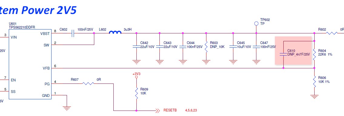

Customers want to get a better response when using Tps562210,
Does this extra capacitor (C610) have a suggested value or maximum value?

this cap will introduce a zero into The loop.So The value is depend on The cross frequence.the C=1.5*Fc/2pi/R604
Hi Hermes,
You could follow Vental's equation to get the optimum value of Cff. In general, you could start to put 10pf as Cff for first try and then increase its value. The max we would recommend is 100pf. Thanks!
