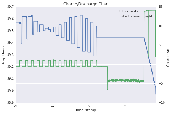

The monitor works well, except that I see the following changes to FullChargeCapacity when the pack is close to full.
The IT algorithm seems to correctly readjust the predicted FullCapacity close to the design of 40.0AH, but with a pulsed load going between charge and discharge at full capacity the gauge seems to adjust FullCapacity up and down by 10%.

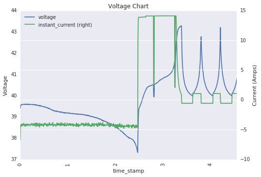

  • In case it's helpful -- here is the voltage / capacity data when the charger is being pulsed every 5 minutes .
  • I don't have any data for during operation with high current (because the device is mobile), but I have observed jumps in full capacity of +/- 30%. This results in early prediction of battery empty. I would love to get some thoughts about what could cause that.

    The fist thing that comes to mind is the fact that FCC by definition varies with current due to the internal impedance of the battery. The greater the current, the greater the IR drop and the lesser the FCC. This is an inherent characteristic of the battery. However, I can't say for sure if the 30% reduction in FCC is actual due to the high discharge current or if the guage is inaccurately reporting FCC. You can actually discharge the battery from full charge to empty using that high current and then coulomb count the passed charge using the gauge to be able to determine what the capacity of the battery would be under that high current. This will let you know if what the gauge is reporting is correct or not.
    Again i have to emphasize that without a log file, I will only be speculating. It is important that you try to get one showing the problem.
