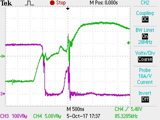

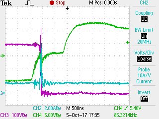

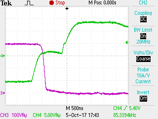

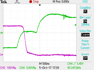

    This behaviour where the CD switches maintain ZVS down to lower currents than the AB switches, is inherent to the PSFB topology. The basic reason is that there is more energy available to drive the CD switches transition than the AB switches transition. The energy available to drive the CD switches transition is that contained in the resonant (leakage + shim), magnetizing and output inductors.
    However during the AB transition the secondary is short circuited by the rectifiers (this is true for both SR and Diode rectification) and of course this short circuit is reflected into the transformer primary too. This means that the energy available to drive the the AB switches transition is that stored in the resonant (leakage) inductance only. ie 1/2 Lr (i_mag_pk + I_Lout_min *Ns/Np)^2
    The ZVS range can be extended by reducing the magnetizing inductance so that the magnetizing current, which flows in the resonant (leakage) inductor of course, is increased or by increasing the resonant inductance. You have seen this already when you changed Lr from 100uH to 50uH.
    I'm not quite sure why the QA transitions need more current than the QB transitions, the circuit should be symmetrical in that the capacitance at the switched node is the same for both devices - are the transformer currents the same for both transitions.

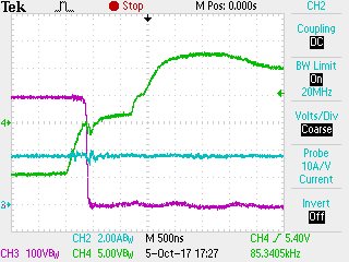

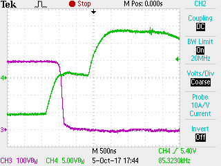

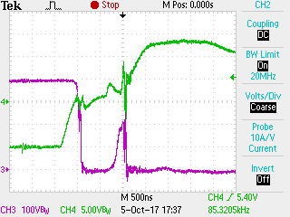

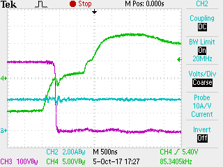

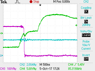

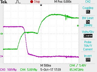

    ==================================== QB 100uH =============================================
    Qb = 4.5A ZVS , CH2 (blue) = output current, CH3 (pink) = Vds, CH4 (green) = Vgs via pulse transformer.
    Qb = 3.9A before ZVS , CH2 (blue) = output current, CH3 (pink) = Vds, CH4 (green) = Vgs via pulse transformer.
    Qb = 3.4A before ZVS , CH2 (blue) = output current, CH3 (pink) = Vds, CH4 (green) = Vgs via pulse transformer.

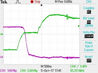

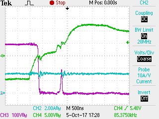

    ==================================== QA 100uH =============================================
    Qa = 1.8A ZVS , CH2 (blue) = output current, CH3 (pink) = Vds, CH4 (green) = Vgs via pulse transformer.
    Qa = 1.7A before ZVS , CH3 (pink) = Vds, CH4 (green) = Vgs via pulse transformer.
    ==================================== QC 100uH =============================================
    Qc = 0.4A ZVS , CH3 (pink) = Vds, CH4 (green) = Vgs via pulse transformer.
    Qc = 0.3A before ZVS , CH3 (pink) = Vds, CH4 (green) = Vgs via pulse transformer.
    ==================================== QD 100uH =============================================
    Qd = 0.3A ZVS , CH3 (pink) = Vds, CH4 (green) = Vgs via pulse transformer.
    Qd = 0.2A before ZVS , CH3 (pink) = Vds, CH4 (green) = Vgs via pulse transformer.

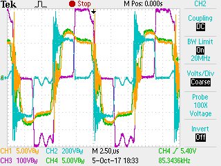

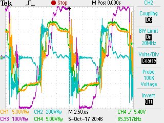

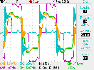

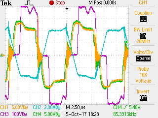

    At 5.3A output load, these are the waveforms.
    Ch1 = OutA
    Ch2 = Pri Inductor current
    Ch3 = Pri Transfomer voltage
    Ch4 = OutD
    Another waveform showing pri inductor voltage
    Ch1 = OutA
    Ch2 = Pri Inductor voltage
    Ch4 = OutD
    As you can observe that even though my controler is already at max duty, pri transfomer is not. Some voltage is dropped on the primary inductor.
    When I try to load to 7A, output would drop to 120V due to transformer turns ratio not enough.
    Then I changed primary inductor to 50uH this is the waveform I get when loaded to 7A and the output is still within regulation.

  • Hello Victor
    It looks like you are making good progress. There is always a certain 'loss of duty cycle' due to the voltage across the primary leakage+shim inductor as you correctly point out. This duty cycle loss is greater with greater inductances. You will need to alter the turns ratio if you need the higher inductance value.
    There is a certain amount of ringing on the top of the primary current waveform due to interwinding capacitances - especially those between primary and secondary. If these appear on the waveform applied to the CS pin then you may have instability at certain duty cycles where the dv/dt rate of the signal at the CS pin is very slow. You may be able to filter the signal or else design the windings in the transformer to minimise these capacitances.
    Colin
