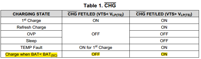

6. BAT < BAT(SC) mean bq24210 into LPCM mode, right? LED on/off show what behavior?

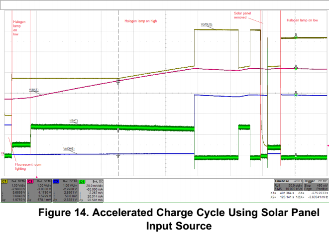

7. I would appreciate it if you can explain below fig.

    Q6. BAT < BAT(SC) mean bq24210 into LPCM mode, right? LED on/off show what behavior?
    Ref data sheet Table 1
    A6. Table 1 will refer to LPCM mode (or not) set by the voltage at TS pin (V-TS). The behavior of /CHG will change depending on LPCM mode and battery short detect will change. See section 8.4.5.10.
  • Question 7 regarding figure 14 is still in work.
