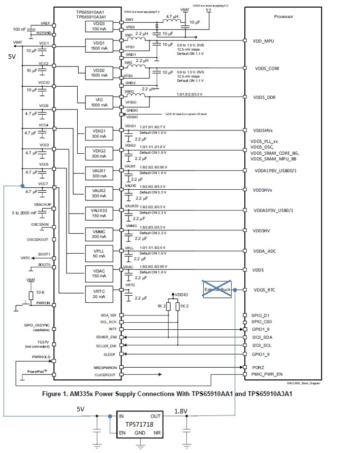

The customer is using TPS 65910AA1.
In their system, a phenomenon occurred in which the microcontroller did not start once about every ten times.
At that time, the TPS65910 is not outputting power other than VRTC.
The circuit configuration is shown below.
After confirming the waveform, PWRHOLD was 'High' at the timing when the 5V power supply rose to about 2.8V.
For that reason they suspect that the timing to make PWRHOLD 'High' need some time from the 5V rise.
It is stated in the data sheet of TPS65910 that the 5V input is judged within the voltage range of 2.5V to 3V.
Please tell me how long it is while turning on PWRHOLD after 5V voltage reaches 3V.
Thanks, Masami M.

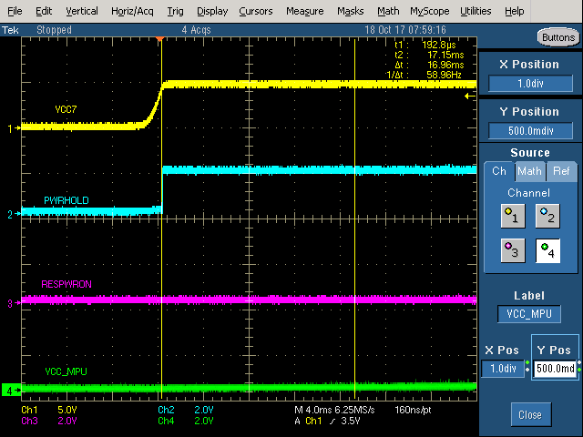

  • HI Masami,
    The PWRHOLD signal is level sensitive, not edge sensitive, so being high prior to VSYS > UVLO should not be an issue. I tested about 20 times and didn't see an issue.
    Figure 6-1 shows the POWER ON enable logic, that may provide more information on what is happening; the gating items for a POWER ON include PWRON long key press and thermal shutdown. DEV_OFF bits shouldn't apply since they would be reset.
    Also note that if the VRTC does not reach it's target of 1.8V, then the OTP will never load and device will be stuck between NO SUPPLY and OFF state.
  • Hi, Kevin-san,
    Thank you for your reply.
    The difference between the previous circuit diagram and the customer's circuit diagram is that PWRON is set to Open and the primary battery is connected to the VBACKUP pin.
    In other words, 1.8V is always outputted to VRTC, and ON/OFF of power supply is done by supplying 5V to VBAT or not.
    A phenomenon occurs in which power supply other than VRTC is not output once every 10 times, but which signal other than the PWERHOLD signal affects this phenomenon?
    OSC32KOUT and VREF are output normally even when a phenomenon occurs.
    SLEEP remains at 0V.
    Please give me advice.
    Thanks, Masami M.

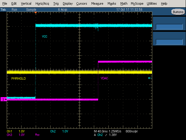

  • HI Masami,
    I'm still not seeing any issue on my side. I've tested PWRHOLD supplied before VCC7 (or any VCC for that matter) and no matter what the part seems to boot. For example, here is 1.8V PWRHOLD and 5V VCC:
    I also tried 3.3V and 5V on PWRHOLD, as well as 4 V and 2.6 - 3 V on VCC in a slow ramp.
    Can you reproduce the issue on an EVM? It may be system specific.
    One other item would be does the VRTC reach 1.8V in the case where it fails to boot? If it gets stuck at even 1.65 V, the OTP would not load and the part would not boot.
