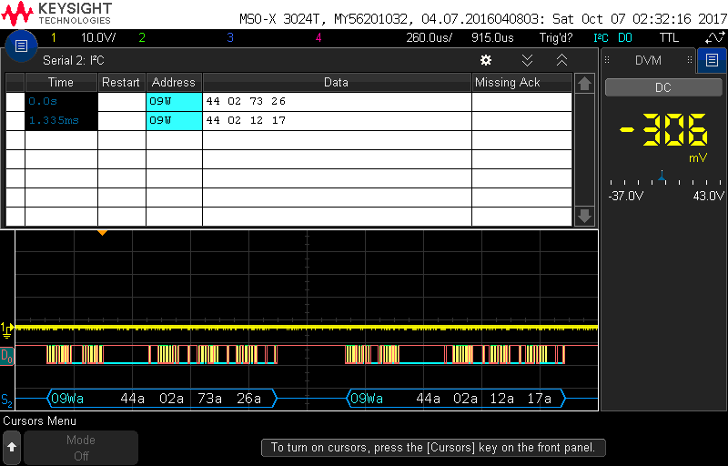

    I'm still having trouble with those recovery commands. I also tried to issue a reset after sending the commands but that didn't help. Here's the trace of what's going out, the commands are only separated by 1.3 ms now:
  • Hi Kurt,
    My apologies, that command was for our older bq20z devivces. Since the unseal and FAS commands never changed for our legacy devices, i assumed, the pf clear remained the same. I looked through the code and saw that the command is a mac access command 0x0029. It is actually in the TRM and it is called permanent fail data reset.... the names our FW developers give these things ha! That being said, try that and see if it clears the pf flag.
    thanks
    Onyx
