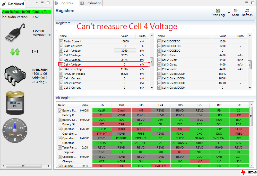

    I used bq40z50EVM-561 to measure 4S1P Li-ion pack that the details are as follows,
    issue 1:
    when output current is zero, but bqStudio could receive current data, nearly 50~200mA.
    Try to "1N NODE" connect to gnd, but it useless.
    issue 2:
    There is only single one Cell Voltage cannot be read by bqStudio, but I can measure the real Voltage on the EVM borad by meter,
    then I had turned the fets on when I send the fet enable command (0x22), but it still useless.

  • Dear Onyx,
    The true thing is in 4S1P cell pack, I got lose the "Cell 4 Voltage",
    it made me confused...
  • Hi Freddie,
    Did you configure the number of cells in the data flash of the gauge for a 4 series pack? if you are configured for 3cells in sereies, the fourth cell wouldn't be measured.
    thanks
    Onyx

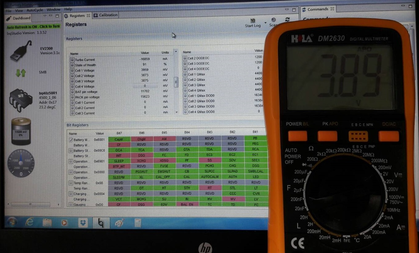

  • Dear Onyx,
    I didn't configured anything, even I used a NEW bq40z50EVM board,
    the situation was the same, still couldn't measured the fourth cell voltage.
    ( PC side fourth voltage is "0V", pack side fourth voltage is "3.89V" )
    How can I solve this problem?  thanks!

  • Hi Freddie,
    The gauge comes configured by default to measure 3 cells. You need to configure it for 4 cells, that is what i was trying to tell you. You need to set the CC1 and CC0 flags in DA configuration and then issue a reset command (0x41) for the device to measure the 4th cell.
