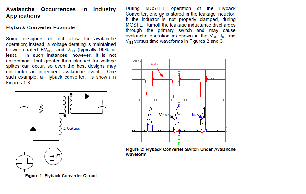

    I would challenge that notion based on text from IRF that suggests NFET DS current avalanche is a protective medium against device destruction and at the very same time can have premature avalanche from improper gate drive current. Seemingly we want the DS current to sustain somewhat relative to Ton period of the gate. Yet TIDA-00778 TI scope captures (fig.33-35) gate drive current indicates gate current falls in less than 250ns @15kHz and then fails to capture the DS current period relative to 80% gate drive duty cycle. So it seems the 250ns gate drive current is far to short to produce any real DS current and the IGBT is not entering forward Transconductance, EC saturation. May not be the case with an NFET under the same conditions but how would I know that by this TIDA publication?
    That is speaking relative to an (unclamped) inductive load being driven by the UCC gate driver.

    All NFET have current avalanche under conditions of unclamped inductive kickback on the wire or from other active switch nodes on the same (shared) wire, such as 3 phase commutation. Seemingly if (IGPK) is not kept constant during the miller plateau the parallel tunnels will collapse (avalanche) or perhaps even the parasitic BJT could trip if the GS voltage rises should gate current suddenly drop (<10us) under very heavy IDS. So 250ns IGPK+ may seem like a lot of time but in light of inductive kickback it my take a much longer IGPK period to maintain high IDS under EMF conditions. Good reasons for having graphs to indicate gate drive IGBP at specific frequency curve in the BW relative to temperature.
    I^R AN1005 page 4-17

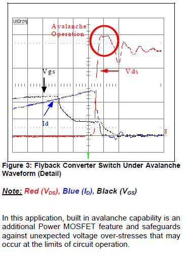

    That unclamped current avalanche occurs most pulses (source 350ma/sink 650ma) and not result of body diode (dv/dt) as some FE suggest as switch node noise ringing shown in the red circle AN-1005 page 4-17.
    I don't think I understand what you mean by an unclamped current avalanche. Avalanche breakdown occurs from drain to source due to overvoltage stress. The ringing overvoltage is a function of the inductance and the rate of change of current, so because the inductor current declines quickly during NFET turn-off in a flyback or with some other inductive load, this causes very high ringing which could cause avalanche breakdown to occur. Is this what you mean by unclamped current avalanche?

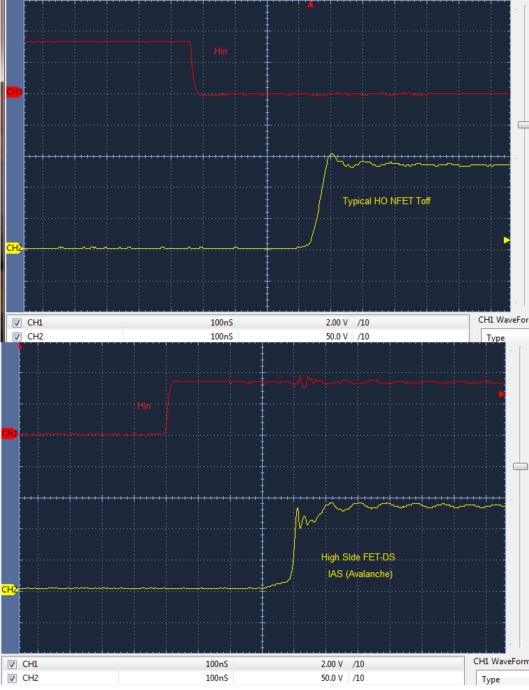

    Or perhaps the ringing in red circle is actually the aftermath of a PN junction collision with EMF in the unclamped inductive (UCI) load such as a solenoid would present to the NFET if the CCEMF is not snubbed. Even the best of circuit designs with a clamped inductive load experience occasional IAs.
    That's my point the actual turnoff event or (perceived) fall in gate drive voltage is due to the IAs event near the end of each PWM period of another node on the wire, not the other way around. The ringing in the coil is the result of IAs as drain voltage suddenly snaps back to full VDD. It just so happens the EMF event in each IAs cycle coincides with the PWM period end and fakes everyone out. We don't clamp the load in 3 phase commutation so the EMF is always present and IAs occurs end of every most PWM cycles and drives down inverter efficiency as the NFET junction heats from excessive IAs events. The event occurs so fast test instruments can not detect the start of NFET DS gate field collapse until after the IAs event occurs. Seemingly we only see the remnant of the IAs collision and think that is normal switch behavior.
    Question is can IAs (avalanche) be arrested by holding gate current high during EMF of another active switch node. In the past 4 amp gate drivers never existed and we only see the old IAs behavior from very low gate current drive.

    That would be a huge gain to compare IGPK drive current of various gate drivers to the 4 amp IGPK of UCC27714. The IAS (avalanche) events are the concern as mentioned the event seems to occur randomly even with high speed Hex-FET having a 39 amp IAS specification.
    Notice the top capture faked me out thinking it was the LO switch tuning off when in hind sight it seems the very same HO switch (bottom capture) but with an IAS avalanche event. Adding more HO/LO gate drive resistance did not help so much at higher BVDSS above 80v, rather helped more at low voltage 24v. Captures; Working voltage 162v-138v,  HO/LO 60/10 ohm, IGPK <10us short to ground, 350ma source / 650ma sink.....
