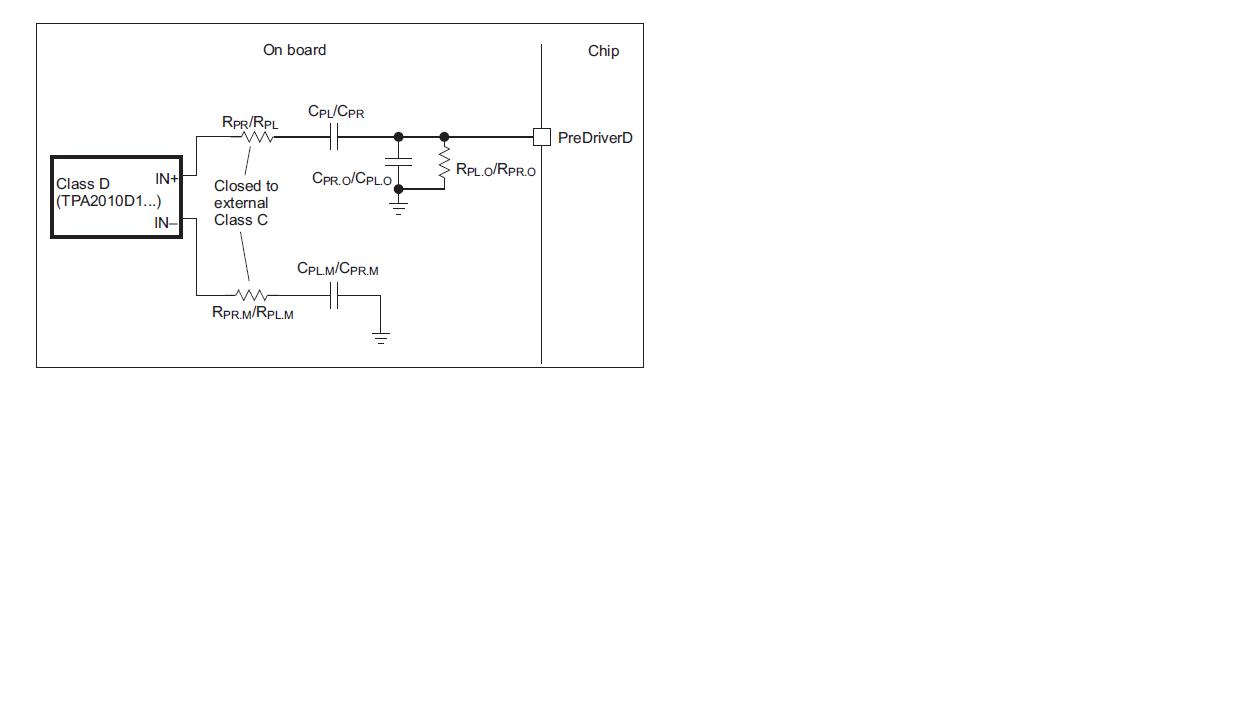

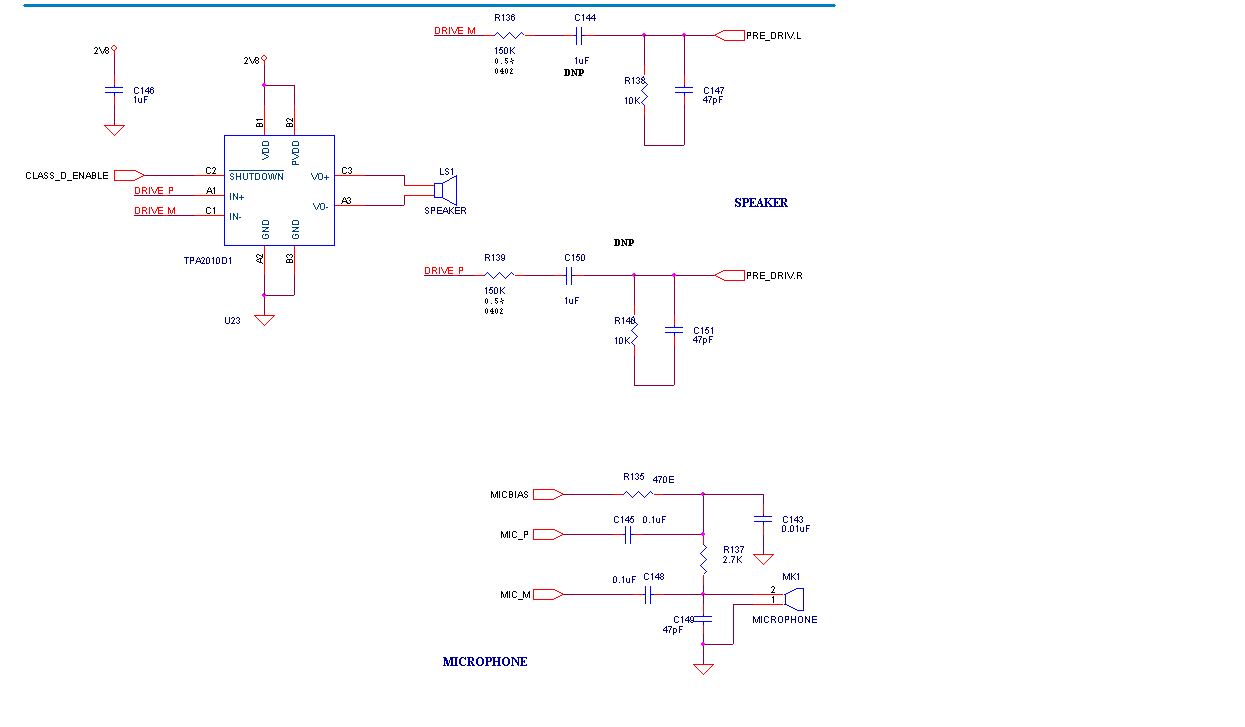

I need to use an on-board speaker (Not stereo headset) with TPS65930 PMIC. There is the no application schematic given TRF.
Should I need to use Class D (TPA2010D1) and if so should I connect both diff lines  PreDriv.LEFT and PreDriv.RIGHT to IN+ & IN-.
Kindly suggest.
