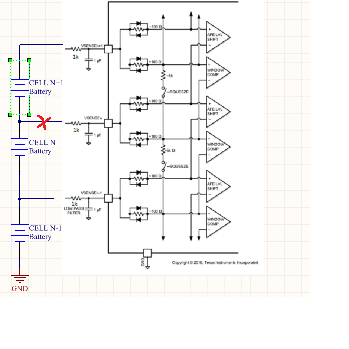

Hi ,
     We would like to test OWD function, and intentional broken wire from CELL 5,14,24,27,30,32. Then measure every cell voltage from three config of CBENBL register.
 Below TABLE show the measurement result. First column  all squeeze resistors be disable result ,second column  even squeeze resistors be enable,
thrid column odd squeeze resistors be enablet.  Every sense pin external series 1k ohm resistor. By observe ,we found not only those broken wire cell  deviate
expected voltage but also the next cell is . It's make me confuse how to know which cell is broken by just looking below table.
CBENBL REGISTER 0x0000 0xAAAA 0x5555
