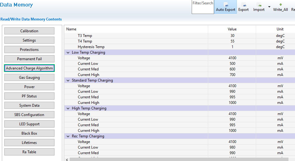

I'm developing a design with 4 Li-Ion Cells and the BQ40Z60 as charger/gauge.
The charging-process is working in constant current mode (CC) but when the battery voltage reaches the "Standard Temp Charging Voltage" of 4100mV (per Cell) the charging continues in CC-mode.
In the manual I can't find the conditions at which the device changes to Constant Voltage mode (CV).
Thank's for your help,
