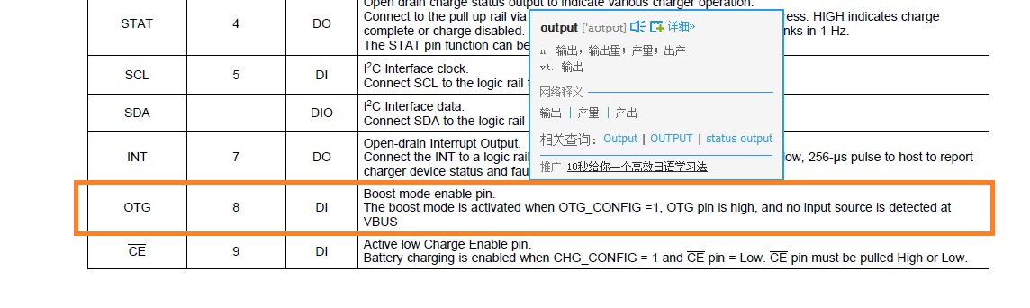

BQ25895M: is it impossible to charge the battery and boost at the same time
Part Number: BQ25895M
Other Parts Discussed in Thread: BQ25895
According to the description at Page 4 of the datasheet of BQ25895, the boost mode is activated when no input at VBUS. So is it impossible to charge the battery and boost at the same time?
  • Wenle,
    The IC can charge or boost not both at the same time.  VBUS is connected to PMID through a FET so, when charging, the V(PMID) ~= PMID.  When boosting, the FET turns off and the boost output is present on PMID.
