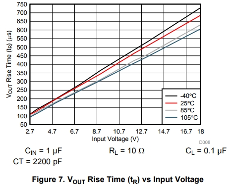

    On the other hands, the rise time has some variation over temperature as shown at  figure 7.
    How much should we estimate the margin for the temperature if we consider the variation of rise time at over all temerature? (46.62 is typical value at 25degC, isn't it?)

  • Hi Koji,
    What VIN voltage is being used? We took timing data across temperature for device characterization, and I can let you know how much the rise time varied to give you an idea of what to expect.
    Alek Kaknevicius
  • Hi Alek,
    Thank you for your support.
    The VIN is min=4.85, max =5.15V.
    Koji Hamamoto
  • Hi Koji,
    Please find below a table of data averaged from 5 units at VIN=5V. This should give an idea of how the device timing varies with temperature.
      -40C 25C 85C 105C Maximum deviation from typ (25C)
    470pF 72.4 67.9 56.8 59.1 16%
    1000pF 93.8 93.4 80.7 82.5 14%
    2200pF 199 197 170 168 15%
    4700pF 418 406 346 349 15%
    10000pF 931 863 745 735 15%
    27000pF 2290 2220 2020 2010 9%
    Alek Kaknevicius

  • Hi Koji,
    The relationship between CT and rise time is pretty linear, so for an approximation, you can use the equation:
    tR (us) = 0.0814 x CT (pF)  + 28
    Using this equation, I was able to estimate 5563us for the rise time at CT = 68000pF.
    As for rise time variation, a higher CT will not always give better variation, so 15% would be a better estimate since it was found at several other CT values.
