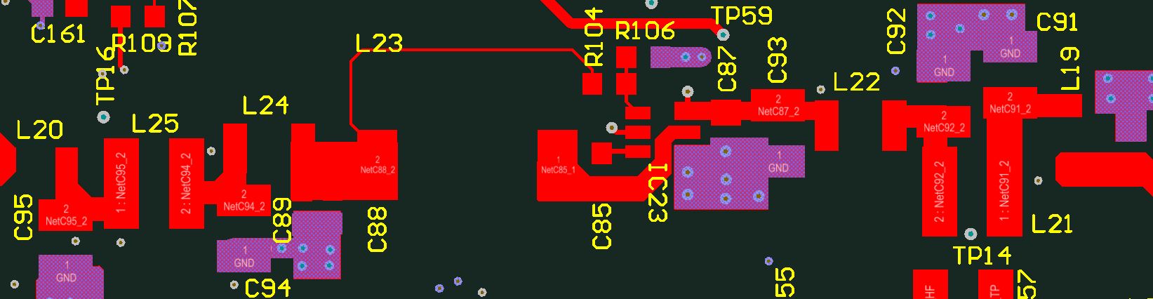

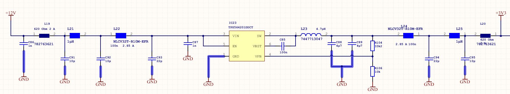

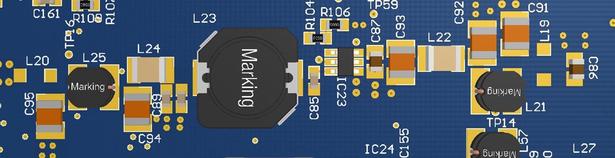

    Hier the schematrics and the layout
  • Hi waht's the purpose of the L21,L57 and L25, the Diff Mode Filter?
     You can also add some beads and small cap(4.7nF) in the input and output as a PI filter to increase the impedance of the high frequency
