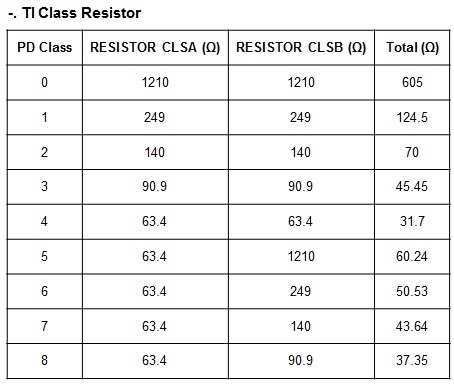

Class 5 is not recognized.
Is the calculated value correct?
Other products are class 5, 21.3 ohms.
Thank you.

    CLSA & CLSB are not in parallel. They are selected during their respective finger. See the functional block diagram on page 15 (www.ti.com/.../sluscd1a.pdf).
    Also notice that a regulated voltage of 2.5V is output from the CLSA & CLSB pins, not 10V.
    Let me look for the correct current values that need to be sensed by the PSE for class 5 power & I can get back to you.

    Current up to Class 4 current is 40mA.
    -. Class 0 : 0 to 4
    -. Class 1 : 9 to 12
    -. Class 2 : 17 to 20
    -. Class 3 : 26 to 30
    What is the current classification current for class 5 to class 8?
    Thank you.
  • Hi BJ,
    For bt. standard classification, there are two class resistors on PD side. And PSE will apply more than 2 finger class events.
    For class 5 to class 8, the first two class events will use class resistor A and it will be set to class 4 resistor and the current is 36-44 mA.
    And then for different class, PSE will apply other class finger events using class resistor B. After the first 2 finger class events,
    For class 5, it will apply 2 more class finger events and the resistor B will be set to class 0 and the current is 0-4 mA.
    For class 6, it will also apply 2 more class finger events and the resistor B will be set to class 1 and the current is 9-12 mA.
    For class 7, it will apply 3 more class finger events and the resistor B will be set to class 2 and the current is 17-20 mA.
    For class 8, it will also apply 3 more class finger events and the resistor B will be set to class 3 and the current is 26-30 mA.
