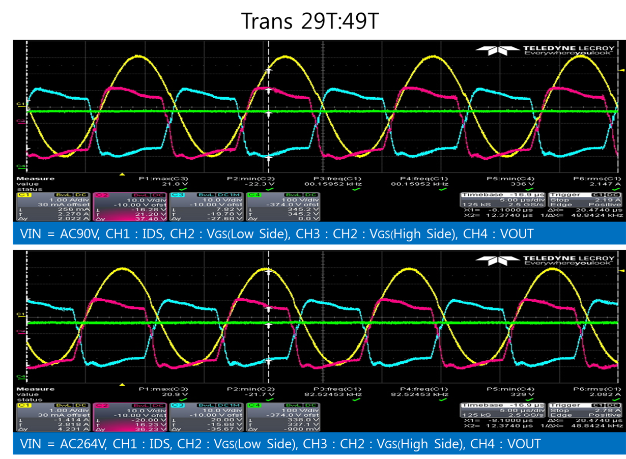

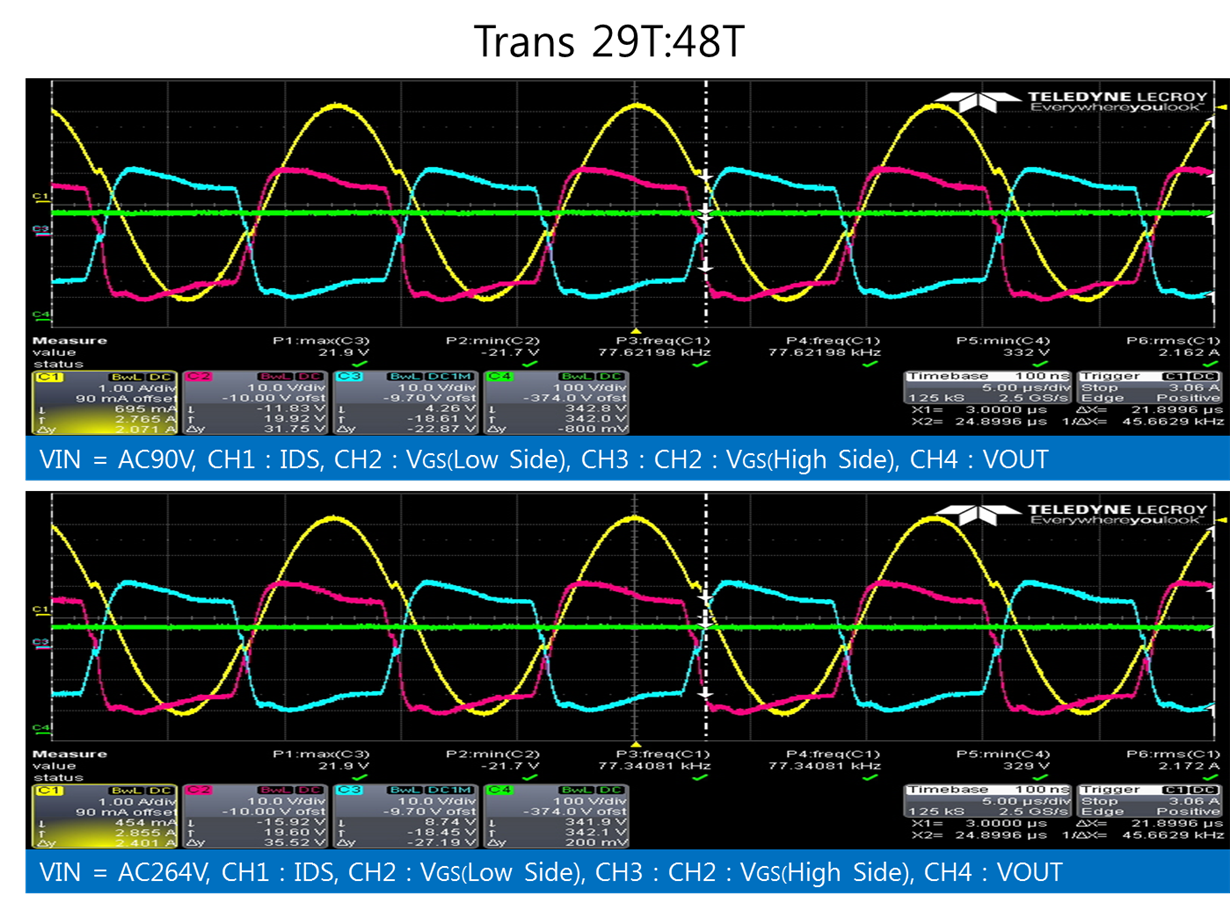

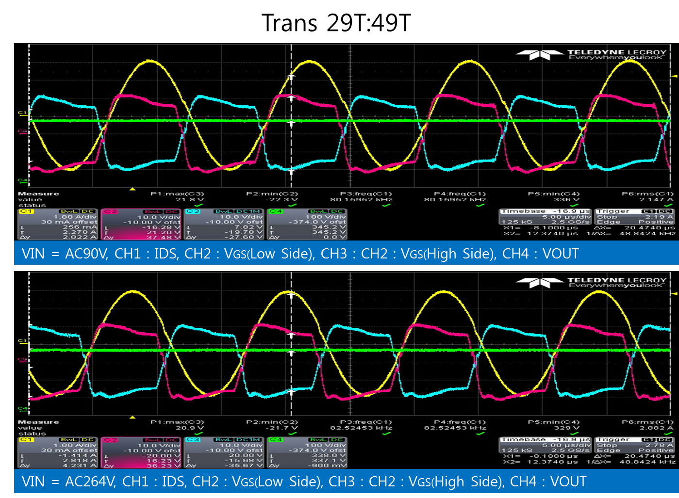

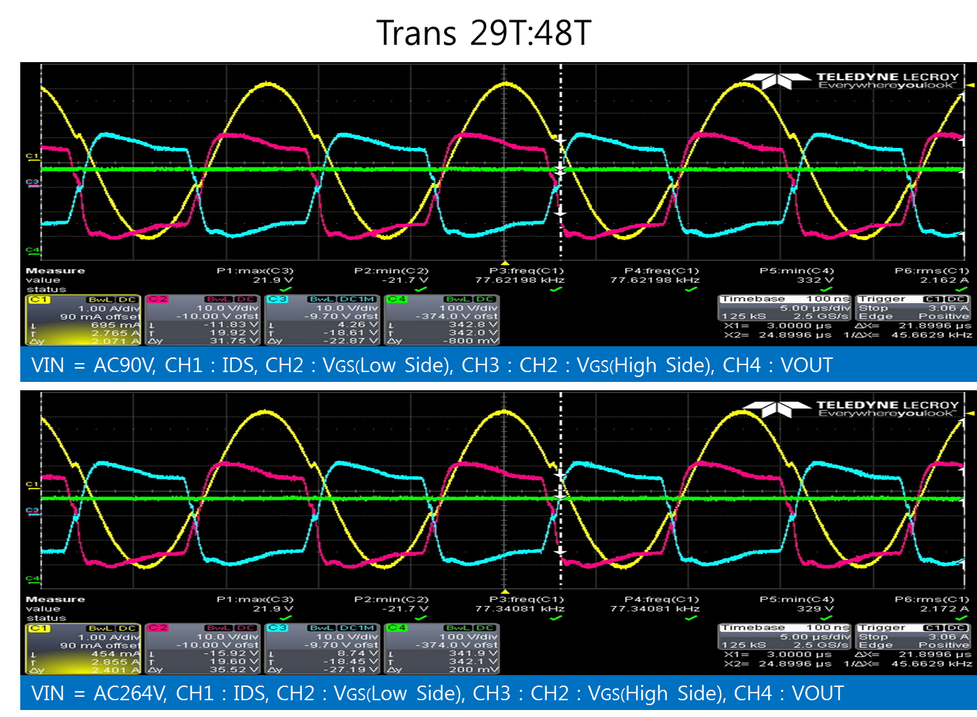

My current customer has built circuit with UCC25600. [350W]
We are considering the choice of transformer for two types of transformer specification.
Attach switching voltage waveform and current waveform. Please confirm.
  • Hi Andy,
    It is not possible to tell which approach is better from the waveforms. Did the customer use the design calculator when design the power stage?
    Has the customer tested the two designs over the complete operating range, did they find any issues or differences between the two approaches?
    Peter
