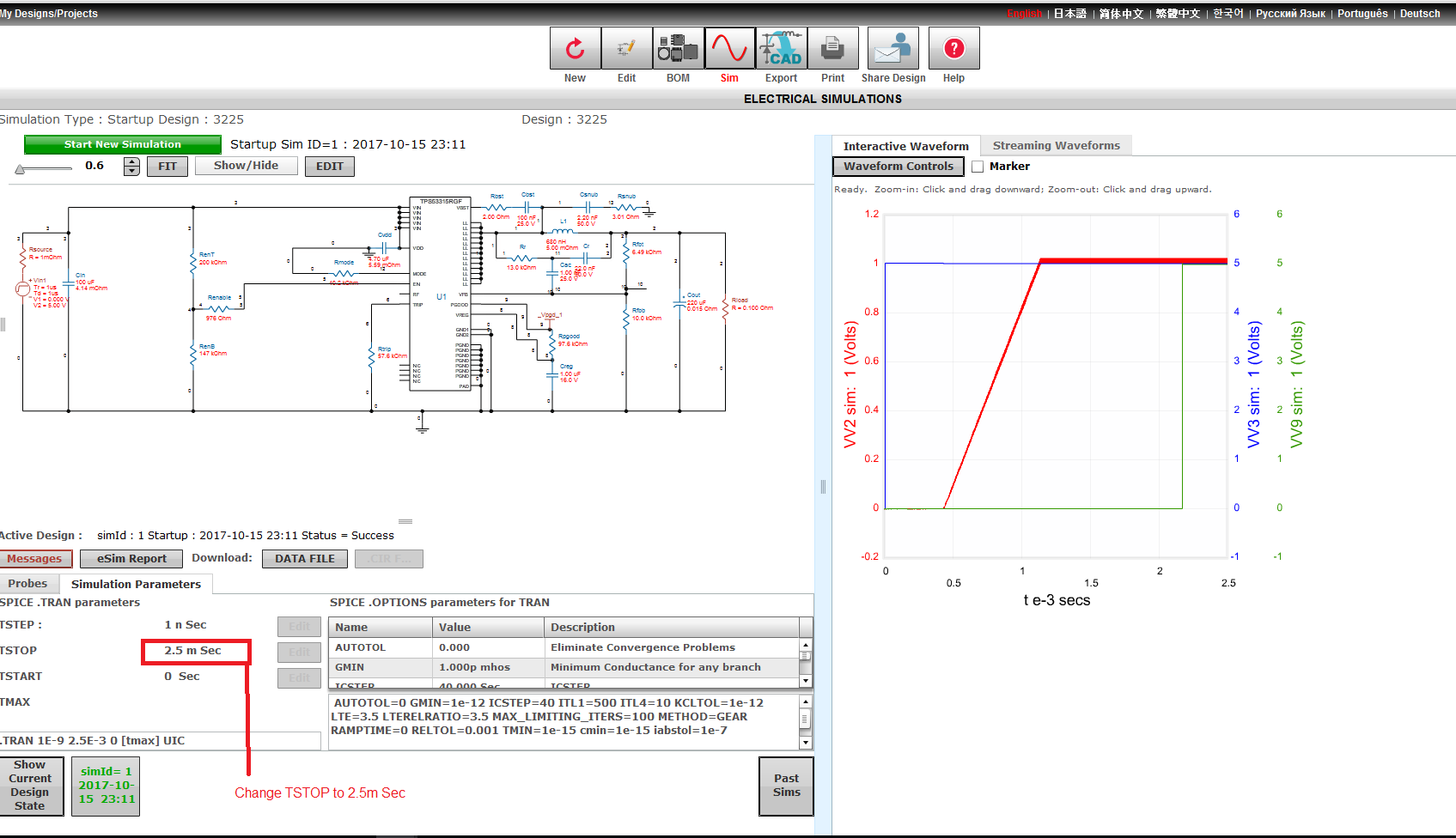

When i simulate the design which is provided by Webench for
- Vin=5v
- Vout=1V
- Iout=10A
And probe the Vin(VV4), Vout(VV3), and PGOOD (VV10) in webench ,
- I get PGOOD in millivolts but here its has been pulled up to VREG(5v).
- And also according to the datasheet PGOOD should start(go high) after 1ms of the output signal has come(ie: when the soft start has been completed),But here in this waveform its coming before Vout?.
- Since i am using the PGOOD of this regulator to enable my next regulator , I am not able to make the power timing sequence (ie : because i want to know after how long my 2nd regulator will turn on, when my 1st regulator has already turned on.
- Is this simulation proper?

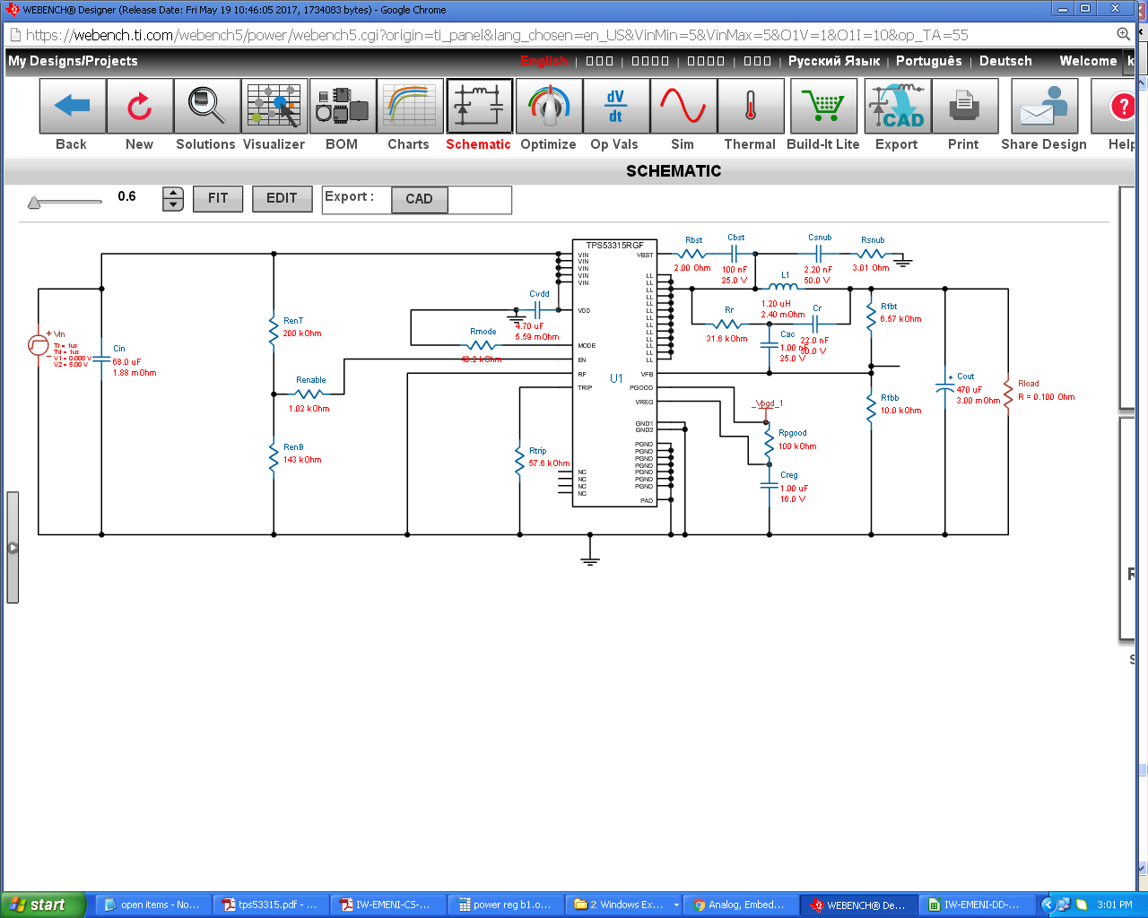

I have attached the webench schematic and waveforms here
- Red colour wave is output
- Blue is PGOOD
- Green is Input wave
