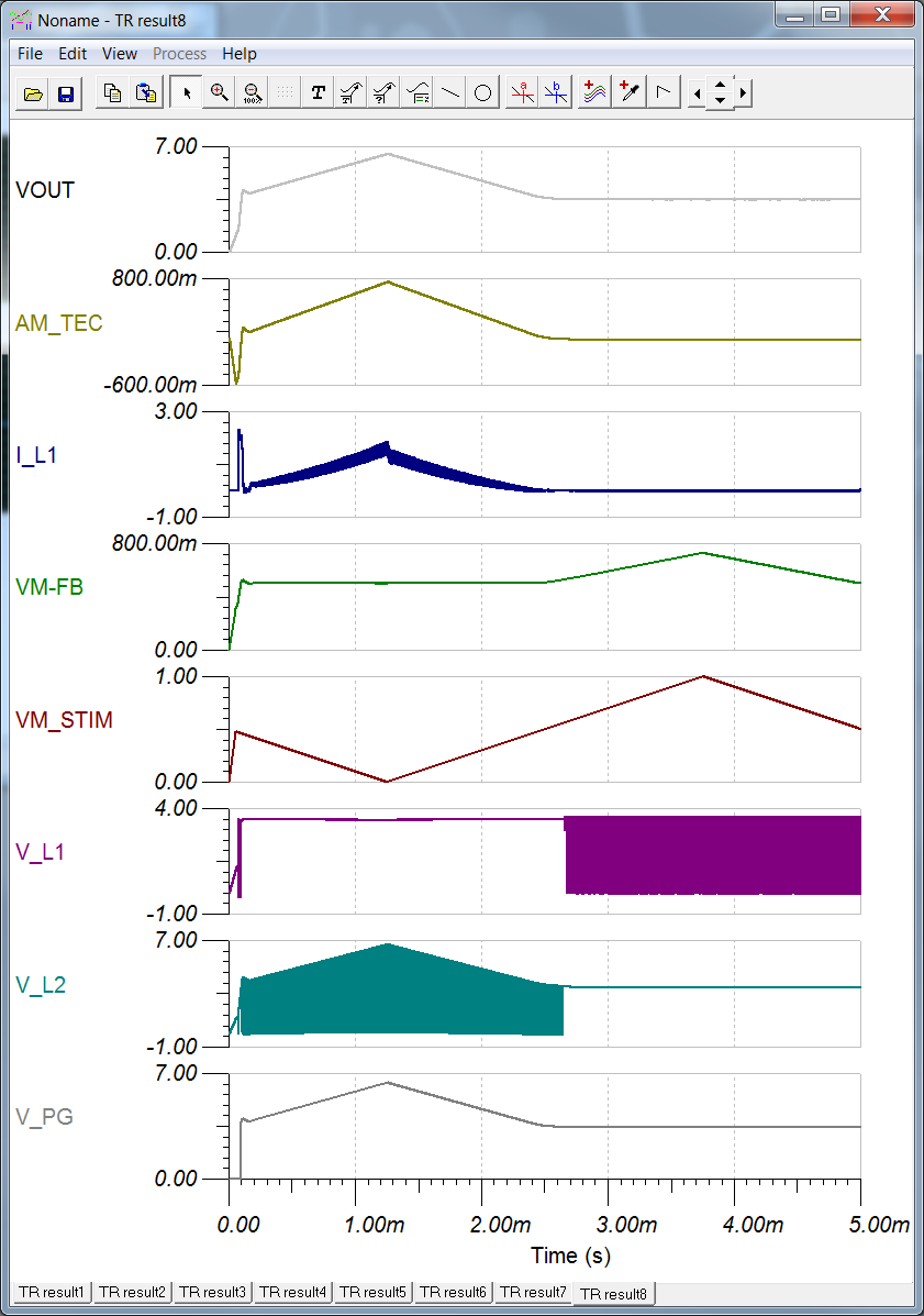

Reading the SLVA677, I considered to make simple TEC driver with TPS63020. I downloaded simulation environment for TPS63020 to TINA-TI - SLIM154, modified schematic according to the app note and run.
When Vin < Vout, it works as expected. Unfortunately, when Vin > Vout, Buck-Boost bridge doesn't recirculate the current flowing through TEC from input to output back to the input.
Could anyone try in TINA-TI and if successful, place there working schematic environment?
Thanks in advance!

  • Hello Jiri,
    After doing some simulation and researches I'm back with an answer.
    In the app-note SLVA677, in particular at the end of page 2, it's mentioned:
    "To drive the TEC properly, the buck-boost converter must source and sink current. When using the TPS63020, this is achieved by forcing the converter in fixed frequency operation. This is done by disabling the built-in power-save mode. Since the TPS63020 can source more current than it can sink, it is important how the TEC is connected to the circuit. In general, the devices which should be kept at a controlled temperature generates heat. For this reason, cooling typically requires more power than heating. So in most cases, the TEC is best connected in a way that it is cooling the device while the TPS63020 is sourcing current."
    Indeed at point 3 the example's characteristics is reported. It shows clearly the effect of the negative current limit when Vctrl is higher then the simmetry point (Which means Vout>Vin).
    So, the result of the simulation should not actually surprise us, given those premises. Although, the TINA simulation does not really fit with the real device behaviour because it is based on a software model. From my simulations, the negative current limit seems to be set a bit higher (closer to 0A).
    To sum up, under my point of view, this application note highlights how you actually can achieve cooling down capabilities, and within a certain extend also warming up, of an apparatus by controlling a simple, cost and space effective buck boost.
    Emmanuel
  • Dear Emmanuel,
    thanks for the effort you spent on my support request. To conclude:
    1. Yes, it is documented in SLVA677 that TPS63020 can sink less current than it can source.
    2. Unfortunately, TINA spice model (encrypted) shows close-to-zero sink capability. For spice models in plain text, I can read release notes where model limitations are published. Where can I read the model limitations for TIencrypted model? Will TI provide model update?
    3. If TPS63020 can sink, where can I read how much - meaning guaranteed minimum, not typical values? Otherwise, I can't plug such device to industrial application.
    Waveforms and *.TSC file follows:
     TPS63020-TECdriver_slim154.TSC
    I rely on your further support!
    Kind regards,
    Jiri
