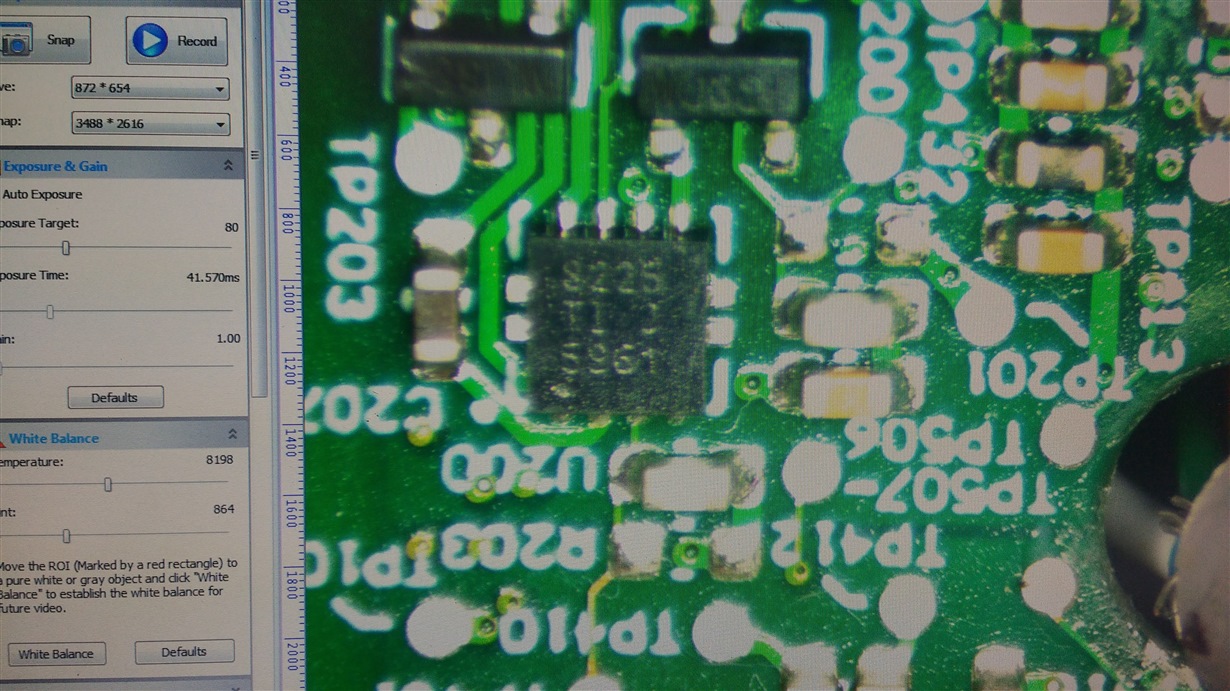

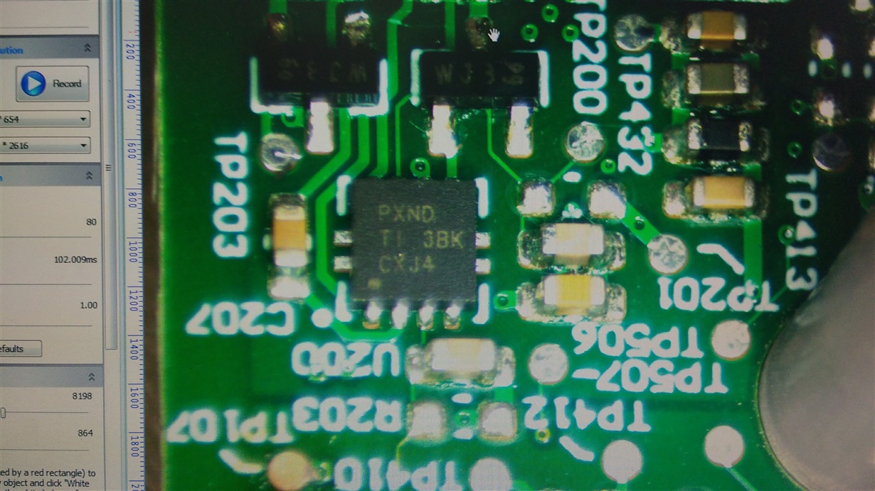

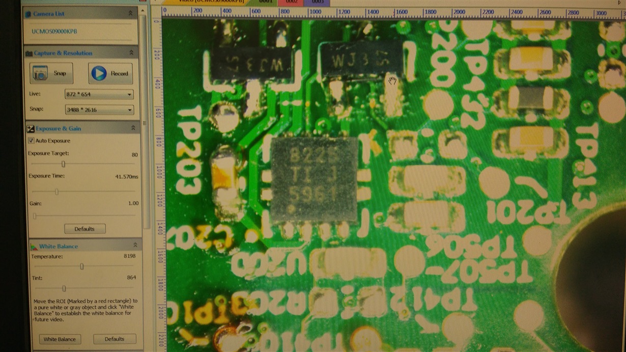

I'm having a strange issue with a TPS28225-Q1.
In my application, I am driving the part with a constant PWM at 125KHz and turning on and off the enable pin periodically every 100 ms approx. No issues with that.
After a requirement change, I decided to keep the enable on all the time (i.e. the part is being driven at 125KHz 100% of the time). When implemented these changes I started getting reports that our units were "locking", they would revive after power cycling them.
In the lab, I found one of the devices had its input signals as expected (PWM and ENABLE HIGH) but I had no output on the gate drivers.
To my surprise, I also found some strange marking on the QFN parts (marking should be PXND but it's something else).
1) Could you confirm these parts are genuine?
2) Is there an issue with leaving a part always on?
Thanks!

  • Hi Leandro,
    1)
    It is difficult for us to determine if the parts are genuine from the picture. The best way to verify the authenticity of TI parts is to be sure to purchase from a TI authorized distributor, more details can also be found at this thread https://e2e.ti.com/group/helpcentral/f/301/t/113197. Note that issues can arise from using genuine parts that have been mis-handled by a non-authorized distributor (also mentioned in that article).
    Looking at the three images, the first line:
    Image 1 shows PXND which corresponds to the SON package for TPS28225-Q1 (the automotive qualified version)
    Image 2 and 3 show 8225 which corresponds to the SON package for TPS28225 (non -Q1 which is the not automotive qualified version)
    Does your application intend to use the automotive qualified version?
