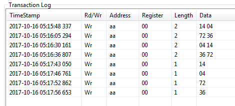

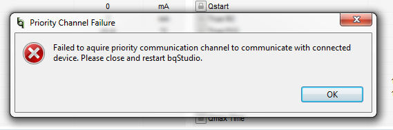

The function "UNSEAL" and "UNSEAL_FULL_ACCESS" of bqStudio does not work correctly (crash / program does not respond). Mainly for "UNSEAL_FULL_ACCESS". These errors happen with Windows x86 or x64 and EV2300 or EV2400... Do you know this type of defect ?
Compared to that : I would like to send the commands manually. Unfortunately I can not make it.
With "Sealed to Unsealed"= 36720414 ; I tried several ways :
 - First way : Command Control(1404) and Control(7236)  -  like datasheet page 21
 - 2d way : Command Control(0414) and Control(3672)  -  tor test
 - 3th way : Command Control(14) / Control(04) / Control(72) Control(36) -  to decompose everything

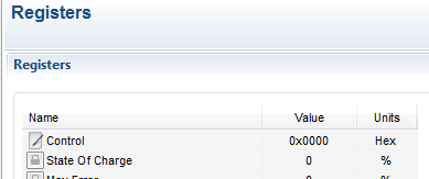

In more, I tried with the main display : Control() register.
Thank you for your help.
