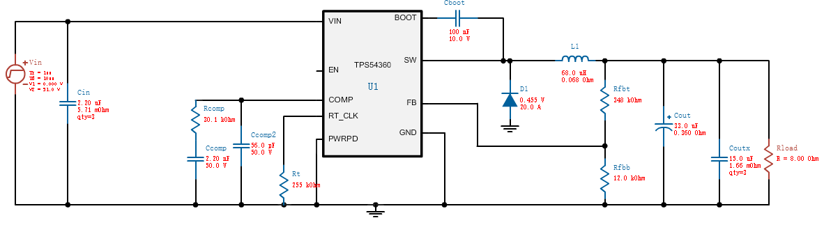

I use WEBENCH using TPS54360 to design the following applications,
Vin:42V~60V,
Vout:24V,
Iout:3.0A,
The incidence of TPS54360 will be burned at full load, the use of Schottky diode chip burn more serious, frequent switch will also burn chip is normal but I output current is less than 1.5A, please help to see which part of the problem, thank you
