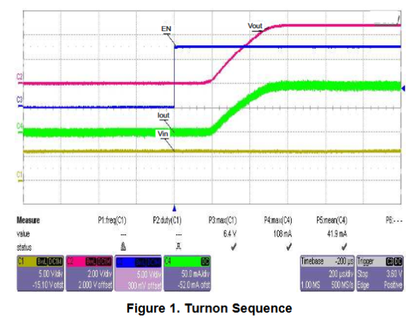

what is the start up behaviour (delay, over shoot) after enabling the device?
