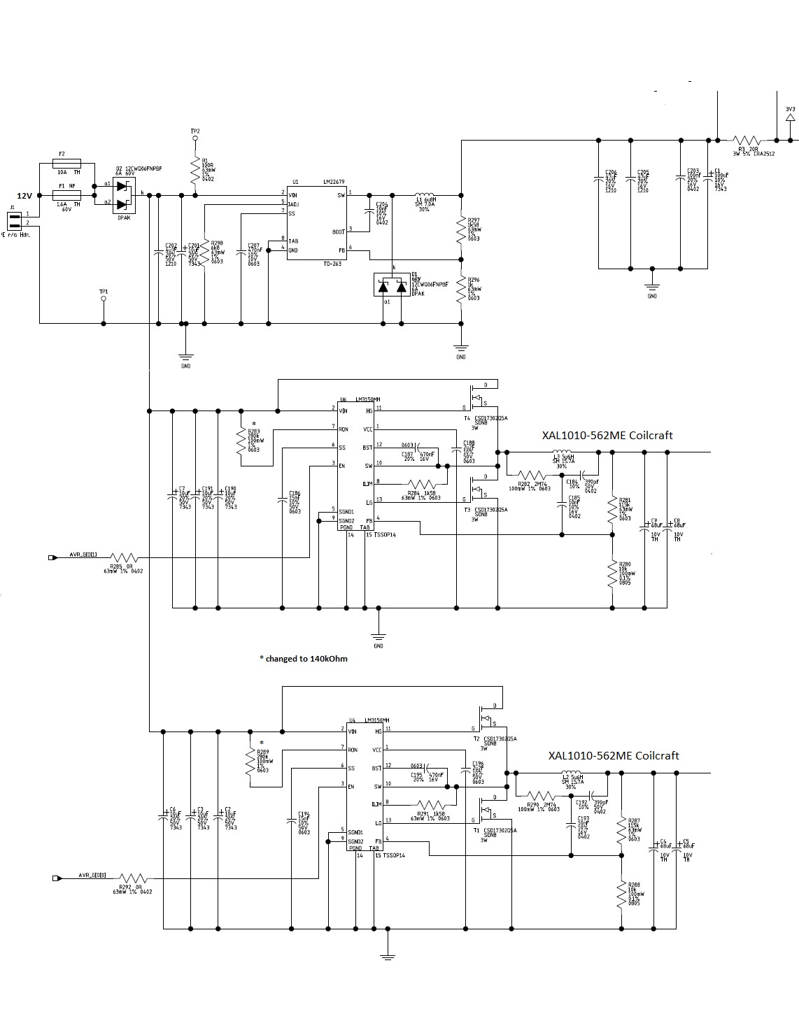

Dear Forum,
I have a customer who has 3 convertors on one power supply board (attached schematic) and has thermal management issues. Please see this link for the LM3150MH design that has been implemented:
https://webench.ti.com/appinfo/webench/scripts/SD2.cgi?ID=200214::power::mike.farley@ti.com
The input/output specs for the two identical LM3150 converters in the real design are less stringent than the Webench design, and are as follows:
Vin = 12V, Vout = 7.5V
1. At up to 4A load current in the first application
2. At up to 8A load current in a later application
Issue:

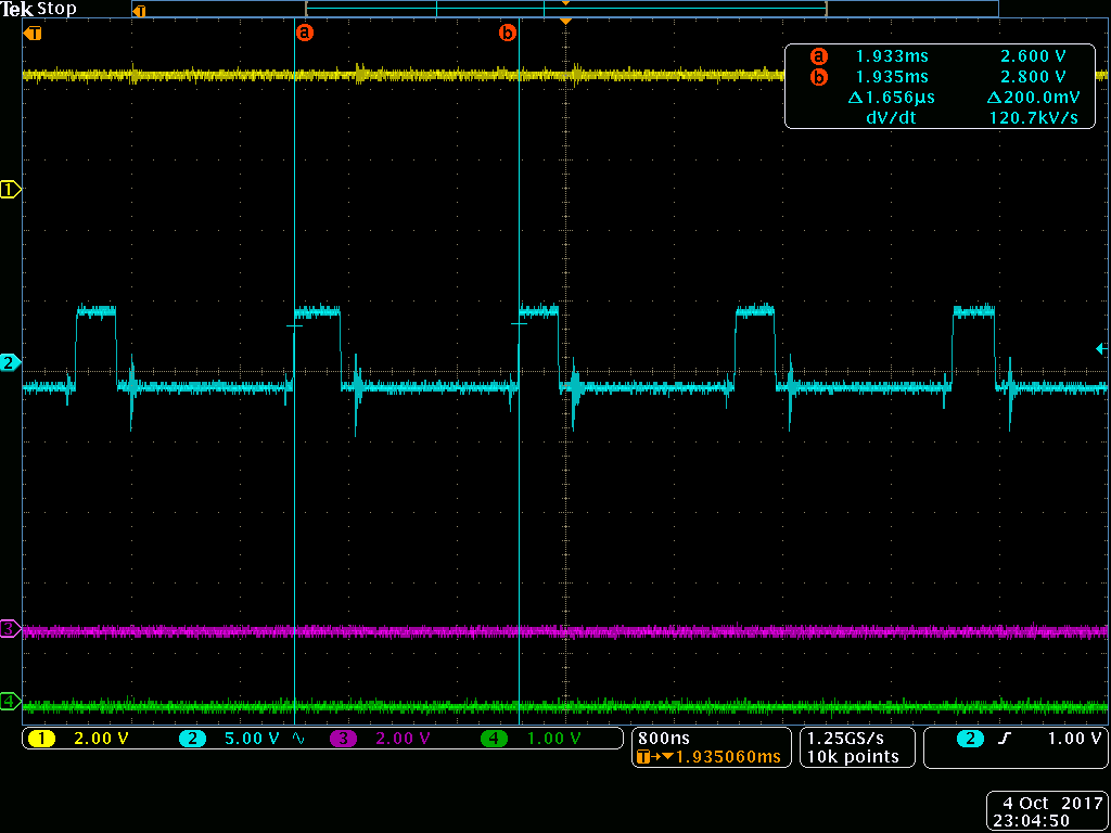

In case (1) above Tcase of M1&M2 CSD17302Q5A Mosfets on both convertors are above 90degC in application. (the whole board is hot indicating good heat sinking - the customer is collecting detailed thermal images at the moment)
Webench simulations say M1&M2 Tj should be around 40deg at 4A and rising to 50-60deg for 8A, and the LM3150 Tj is 38DegC across the loading.
-> Please review and advise. Waveforms and schematic attached.
Many thanks!
Mike
