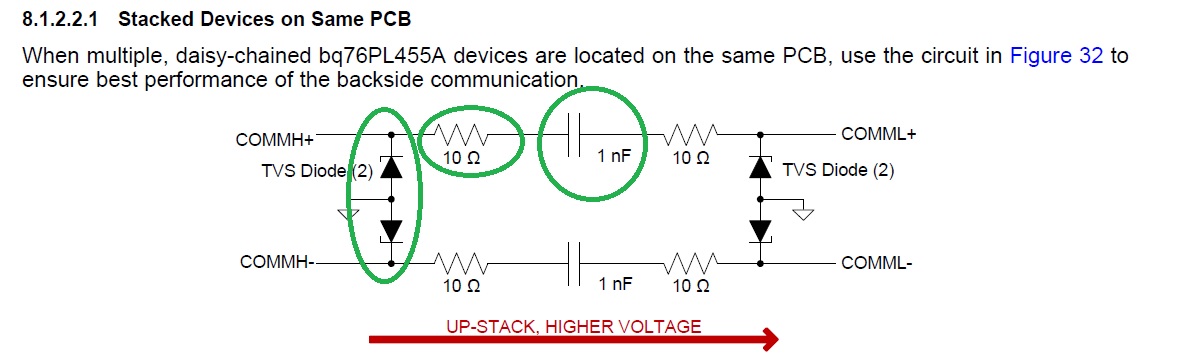

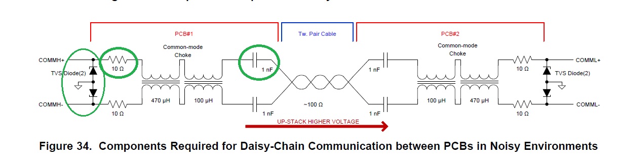

are the components ( green circles in Picture below) used for communication on same PCB and communication on two PCB´s the same ?
And what component recommendation can u give me for the 1nF Capacitor as well as for the 10 Ohm resistor ?
