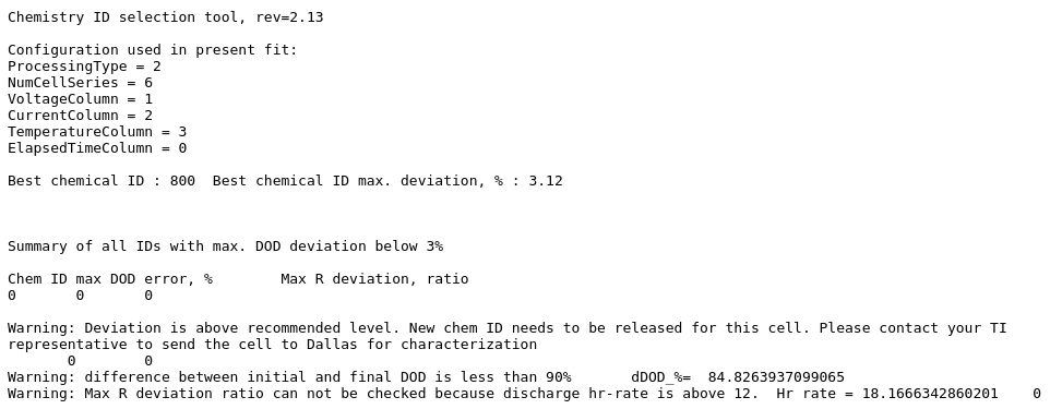

  • I am no expert, but allow me a few remarks before my colleagues takes over me:
    1. chemid is supposed to be 0800, not sure if it is in hexadecimal originally, which would translate to 2048
    2. this is only a discharge log, and I am not sure but I think the tool also needs a charge
    3. CSV is not formatted correctly
    PS: attached to this message, the original chemid result and the log (C/20 discharge) which lead to it20160616 - log discharge.zip
    Chemistry ID selection tool, rev=2.13
    Configuration used in present fit:
    ProcessingType = 2
    NumCellSeries = 6
    VoltageColumn = 1
    CurrentColumn = 2
    TemperatureColumn = 3
    ElapsedTimeColumn = 0
    Best chemical ID : 800	Best chemical ID max. deviation, % : 3.12
    Summary of all IDs with max. DOD deviation below 3%
    Chem ID	max DOD error, %	Max R deviation, ratio
    0	0	0
    Warning: Deviation is above recommended level. New chem ID needs to be released for this cell. Please contact your TI representative to send the cell to Dallas for characterization
           0	0
    Warning: difference between initial and final DOD is less than 90%	 dDOD_%=  84.8263937099065
    Warning: Max R deviation ratio can not be checked because discharge hr-rate is above 12.  Hr rate = 18.1666342860201	0
  • Hi Pial, Hatem
    The chem id should not be converted. What the tool returned is already in hex so it should be chem id 0x800 you program on the gauge.
    Pial, you are right, the toll needs a charge.
    You can see from your gpcchem report that your difference between initial and final DOD is less than 90% dDOD_%= 84.8263937099065 . You need to charge the cells to the max spec in the data sheet and discharge to the min voltage spec in data sheet.

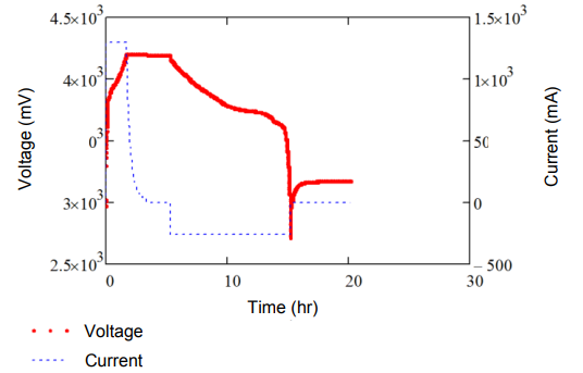

  • Hi Gaël,
    I tried to massage the data on this end to get it through the tool, but was unsuccessful.
    Unfortunately, after the initial charge and discharge, there is no rest period.  For the tool to operate correctly, please ensure there is at least a 2 hour rest period after charging and a 5 hour rest period after discharging.
    The image above is a cleaned up representation of your data (removed the charge period without relaxation in an attempt to get the data through the tool), but it should look more like the image below:
    Please note the 5 hour rest period after charge and 2 hour rest period after discharge, as shown above.
    If the above discussion helped resolve your issue, please click on the "This resolved my Issue" button below to help others with a similar question find this answer.
    Sincerely,
    Bryan Kahler

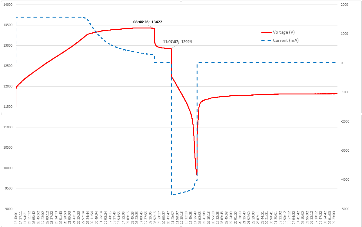

  • Hello Bryan,
    I am confused, we did the process correctly. Please check the following chart based on the logs we sent you.
    As you can see, we charged the battery until 8:46am. At this point, the voltage (13.422 V) was the charger voltage and not the battery voltage. So when we disconnected the charger, the battery voltage went back to the actual battery voltage (12.924 V).
    Plus, you can see that we waited for 2:20:41 (from 08:45:26 to 11:07:07), so the relax period was respected.
    After the discharge, you can see that the relax period was long enough. We actually let it relax during the weekend, I removed the end part of the data to improve the display.
    I am not sure how we can improve our learning process since all the requirements are fulfilled.
    Can you please provide us another solution ?
    Thanks in advance for your time and patience.
    Gaël
  • Hi Gael,
    Can you pls clarify what the issue is at the moment. I am reading through the post and it seems you are having learning cycle issues. But then again you seem to be trying to identify a chem id.
    Your earlier posts indicate that you ran the files through the tool and you got chem id 800 with a deviatin of max DOD error greater than 3%.
    That means that your likelihood of learning being successful is very small because you aren't using a good enough match for the chem id. The criteria is teh Dod error should be less than 3%.
    - You can either rerun your chem id identification (gpcchem) ensuring that you are discharging to the minimum voltage specified in the cell manufacturer data sheeet and charging to the max charge voltage as well, to see if you will get a chem id with dod error less than 3%, after which you run a learning cycle.
    or
    - program chem id 800 on your device
    -extract a gg file which will have the default settings of the chem id and then use that gg file file and the log file you sent earlier to submit to gpcRa0 to calculate the qmax and Ra table values. The returned file the tool sends you will be your learned file which you will program on your device and run a few (2) cycles to verify accuracy.
    thanks
    Onyx
  • Hello Onyx,
    To be clear, we are desperately trying to do the learning cycle for weeks. We tried the normal way with bqStudio but the Ra Table and Qmax Cell 0 never change
    So you suggested another solution here : , which was the Gauging Parameter Calculator tool (http://www.ti.com/tool/gpcRa0)
    And the first time we had some issues with the charging and discharging logs so we repeated a complete Charge and Discharge cycle as shown in my last message. And still, we have no correct results from this tool.
    Therefore, in your last message you told us that the chem ID (0x800) was wrong. First of all, I have check with bqStudio and the chem ID is set to 0x800.
    But I am highly surprised if you tell me that the chem ID can't be 0x800 because I think  told us, in June 2016, that the chem ID was 0x800 and we use the same kind of battery. We used a new battery to be sure that everything is fine on this part.
    Here is the chem ID selection made by TI :
    If I understand you correctly, the learning cycle will never work because the chem ID you suggested doesn't actually match our real battery ? What other solution is left for us ..? :-(
    Gaël
  • Hi Gaël,
    Unfortunately, the data log is not sufficient to generate a chemID match for the battery. This is due to a few issues in the learning cycle that we can fix.
    The voltage requires more time to rest after the charger has been disconnected before beginning your discharge cycle.
    With respect to the discharge cycle, the battery is being discharged at too high of a rate. Your data shows the battery discharging in 3.5 hours. Please use a discharge rate between C/5 and C/10. I prefer to shoot the middle and discharge at a C/7 rate.
    Also, the discharge is not a constant current discharge. Please use an electronic load to enforce a constant C/7 rate.
    In summary, modifications to make to your current test procedure:
    1. Increase the rest time after charging until you see the voltage relax
    2. Ensure the discharge is constant current
    3. Set the rate of discharge to be C/7
    Please submit the new log to the GPCCHEM tool.
    If there are any issues, please let me know and I'll test your new data on this end as well.
    Sincerely,
    Bryan Kahler
