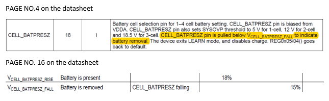

I am using BQ25703A for the battery Charger for 5*AA NiMH battery Pack.
When i remove the battery pack the CELL_BATPRESZ does not fall to below 15% of REGN. Datasheet Specify's on page 16.
The Charger does not set the Charge current to 0 when bettery has been removed and BATFET is ON causing the charge Voltage present at VBAT connector.
regards
Babar
