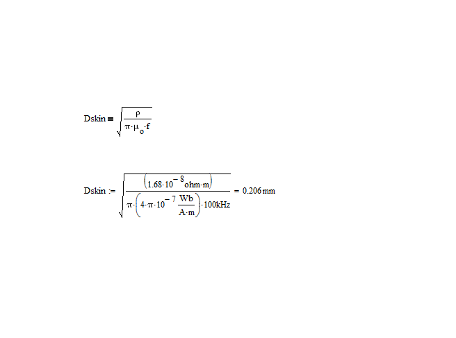

Hello Magnus,
I went through the calcuation of skin depth from the application as you did and came up with the same number that you did.
I have used the following equation to calculate skin depth for copper and the units work out. I calculate the skin depth of a copper wire at 100 kHz to be roughly 0.206mm
Mike
