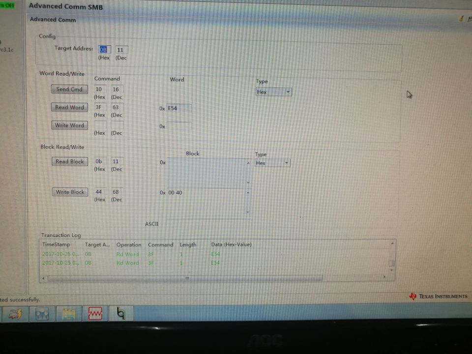

             When I  connect SMBA direct to groud ,I open the BMS (Battery Management Studio)soft,It will automatically identify the bq78350r1 chip and the Registers Interface is highlighting. I tested the basic functionality that was normal and disabled the [FIXED_ADDR]  (set to 0)

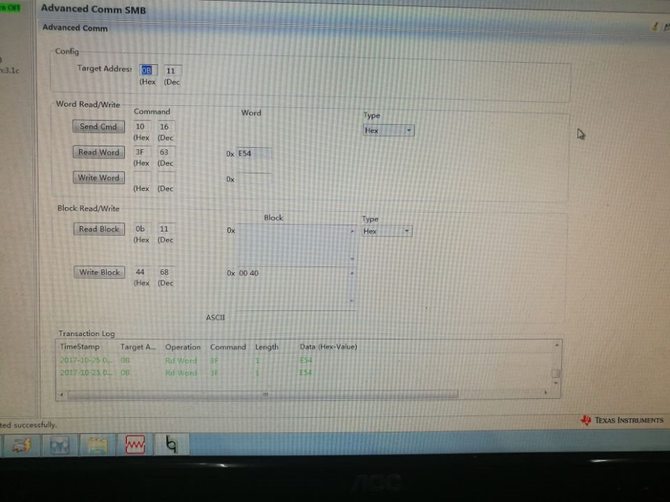

              But when I connect SMBA direct to DC power 0.2V ,I open the BMS (Battery Management Studio)soft again. It cannot automatically identify the bq78350r1 chip ,So i  manually select the bq78350r1 chip and the Register interface is gray not highlight. So i think the communication is unnormal. But when I opened the Adanced Comm SMB interface and enter the address,it responsed as follow:
    So i think the communication is normal in fact,but why when i open  the BMS (Battery Management Studio)soft , it cannot automatically identify the bq78350r1 chip and i  manually select the bq78350r1 chip and the Register interface is gray not highlight
    How can i solve it and how do i understand it?
    Thank you!
       Laker Lian

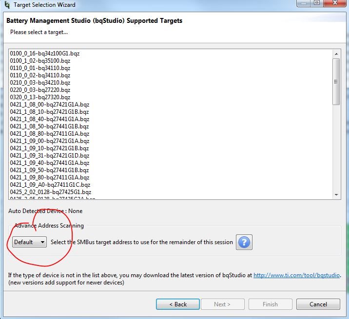

  • Hi Laker,
    Bqstudio can only respond to the default address. Once you change it, or clear the fixed_addr flag, it will not repond.

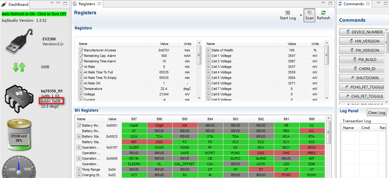

  • Hi Laker,
    I did not realize the functionality has been recently added to bqstudio that allows you to chose a different address which you changed it to and communicate with the device. See snippet below.
    2. In MP you should be able to communicate with the gauge.
    thanks
    Onyx
  • Thank you Onyx,Now the problem has been solved!!!
