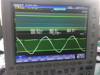

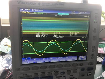

I am now using UCC28180 for PFC control. The problem is when I increased output power to 1.3KW, there has a peak on current.
This cause really high power loss. The AC input voltage is 220v. The output DC is 72V.
The voltage and current in 800W output:
Output current and voltage in 1.3KW:

    Could you help to confirm the output voltage is 72V? I think it would be 372V.
    Have you checked signal of ISENSE pin? the peak voltage at full load and low line should be higher than 0.259V.
    It would be helpful to decrease current shunt.
