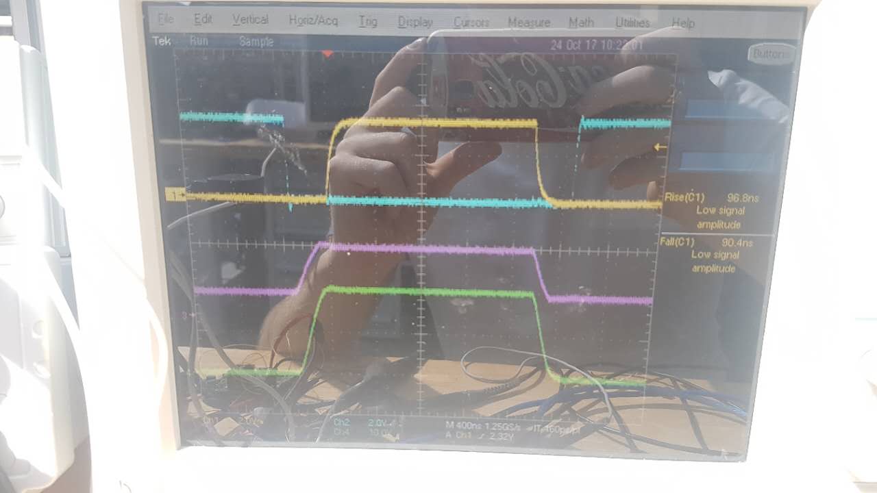

  • It failed at low current of 30mA.
    With the diode fix we went up to 120 watt (40V 3A) with no issue. Below is the oscilloscope picture I had saved from before (no external diode).
    PWM input:
    Period: 4.25us (235kHz)
    duty cycle: 50%
    Dead band: 4 clock cycles
    yellow: PWM HI
    blue: PWM LI
    Purple: HB
    green: HS
    This is at 30mA load, VIN was 20V I think
    driver is 39 degrees celcius
    CH1,2,3 2v / div
    CH4 10v / div
    I can make a new capture of all the driver's output tomorrow.
    On the oscilloscope (with the diode fix) you can still see ringing below ground. (measure at the input of the inductor) . My guess is that this went too much below ground and killed something in Q4.
    I'll show it on the oscilloscope tomorrow.
  • Hi Thijs,
    Sorry for my late reply, thanks for follow up info.
    To confirm, the scope shot above is with no diode fix?
    And you will send me a scope shot with the diode fix soon?
    Let me review your scope shot and get back to you asap, my response might be delayed a day due to a 2-day training I currently am in the middle of. However I will try to get a response to you before end of thursday.

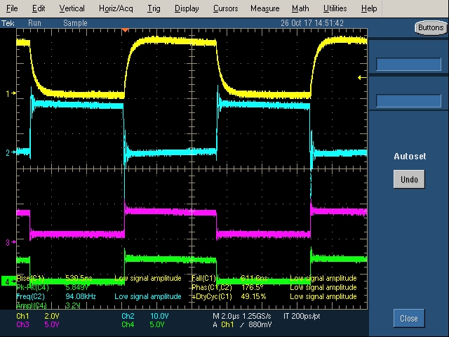

  • Pin: Probe mode:
    yellow: HS X10
    blue: LO X10
    Purple: HB X10
    green: HO X10
    Probe impedance: 1M
    Duty cyle 50%
    load current 6A
    Vsupply 30V
    I put a SS510 diode parallel over Q3 and over Q4
    Some notes: Last time I had the probe impedance on 50 ohm. This had a lot of effect on the Driver capacitor charging.
    At some times my VCC14 dipped and caused the mosfet driver to switch off (this was due to a setup error)
    Temperature at this load is 70 degrees celcius now. The shunt resistor is getting so hot; the driver and mosfets are at lower temperatures.

  • Hi Thijs,
    The probe impedance of 1MOhm gave cleaner results than the 50 Ohm?
    the LO-VSS waveform has lots of ringing on it. Can you zoom in on the falling transition?
    are the FETs damaged with the 6A load in the testing shot above?
    do you mean R5 when you say shunt resistor? what size is your shunt?
