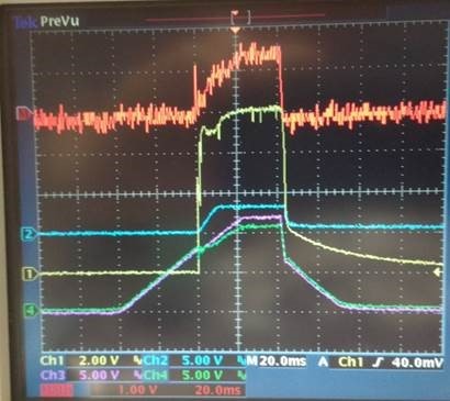

LMR14020: Power supply overshoot
Part Number: LMR14020
I am using the LMR14020 to convert from 24V to 5V. During startup we are noticing an occasional overshoot past 5V along with the soft start not working as intended. We do have a fairly slow ramp on the input side from 0 to 24V (100ms).  Does the ramp time influence this?
