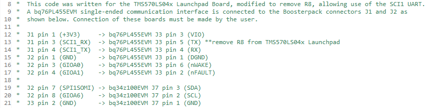

  • When using this code, how are the connections made? in sys_main.c, it says to use connectors J3:1-6 and J7:1-3 on the BQ76PL455EVM, but these do not match with the connections on the EM1402EVM.

  • I am connecting from my computer to the LaunchXL-TMS57004, and from there to the EM1402EVM. Attached is the comment I am concerned with.
    I assumed the 1402EVM J7 connector is the equivalent of the bq76PL455EVM J3, and connected these pins according to this instruction.
    The second set of pins labeled in this instruction I was unsure about. For those labeled as bq34z100EVM J7, I hooked up to the 1402EVM pin J2.

    It appears that there is an error in the comments - there is no bq34z100 on this evm (it is a guage device).
    J6 is the fine pitch header on the EM1402 EVM, right next to U3 (UART header). The J6 header gives access to the pl455 GPIO's, which also acts as the SPI lines, etc.
    J1 and J2 are the TMS570LS04 launchpad headers.
    Please also make sure you follow the TMS570 modifications in the design guide, i believe in Fig 6 and Fig 7. On the launchpad you must remove R8 and R9, as well as solder the TMS570emulated UART pins to U2, which allows you to use the pl455 GUI for ACB.

  • The EM1402EVM sys_main.c code that I sent a picture of says that I must connect to the bq34z100 header j3, which as you said, does not exist. It also says that I must connect to the J7 header pins 1-3 on the bq76pl455EVM.
    On the EM1402EVM board, J3 is the connector to the battery cells, so I assume that is incorrect. The options that seem to make sense in this case is J7, a 6-pin Molex Serial connector - I found that this was designated as J3 in the manual, but not on the board.
    So, in the EM1402EVM code, it tells me to connect to J3 and J7 - which either appear to be the same header or at least one of the two is designated incorrectly.
    In the "Active cell balancing using bq76PL455A" pdf, it tells me to connect to the EM1402EVM headers J3 and J6. J3 seems to match up with the header described in the manual as J3 and labeled J7. In another help forum, ()  it was stated that these go to the header labeled on the board as J2.

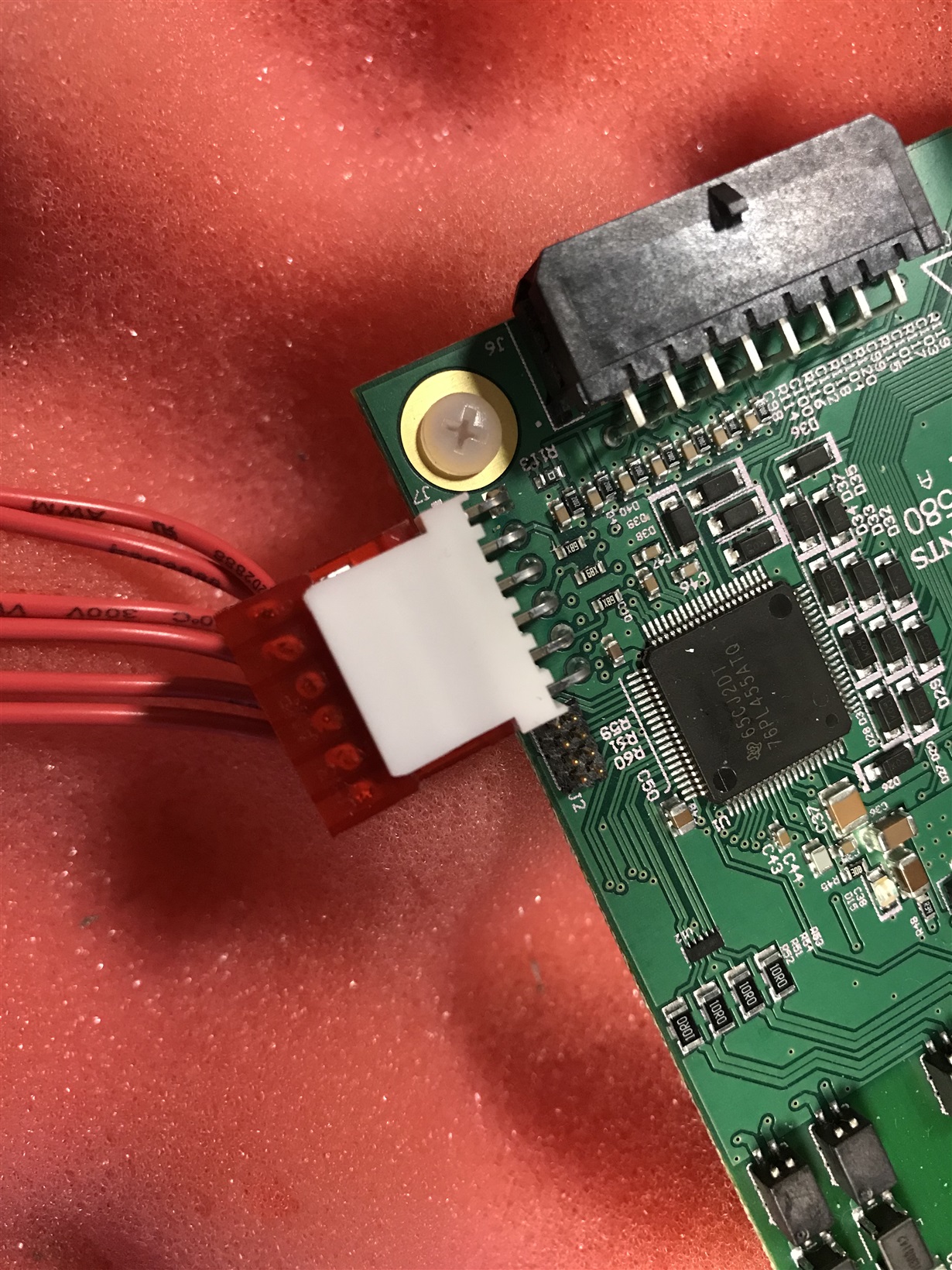

    I will attach a picture of the corner of the board in question as soon as I can.
  • Here is a picture of the corner in question.
  • Emory,
    As you mentioned, J6 is indeed for the thermistors.
    J7 is for the UART/bq76pl455 nFault/ bq76pl455 wakeup. if you wanted, this is the bare minimum for connections to be made. From here, you can bit-bang SPI commands to control the EMB devices.
    J2 brings out the pl455 GPIO pins, which are also the SPI lines, etc. You can connect these directly to the MCU if the MCU is controlling the EMB devices.

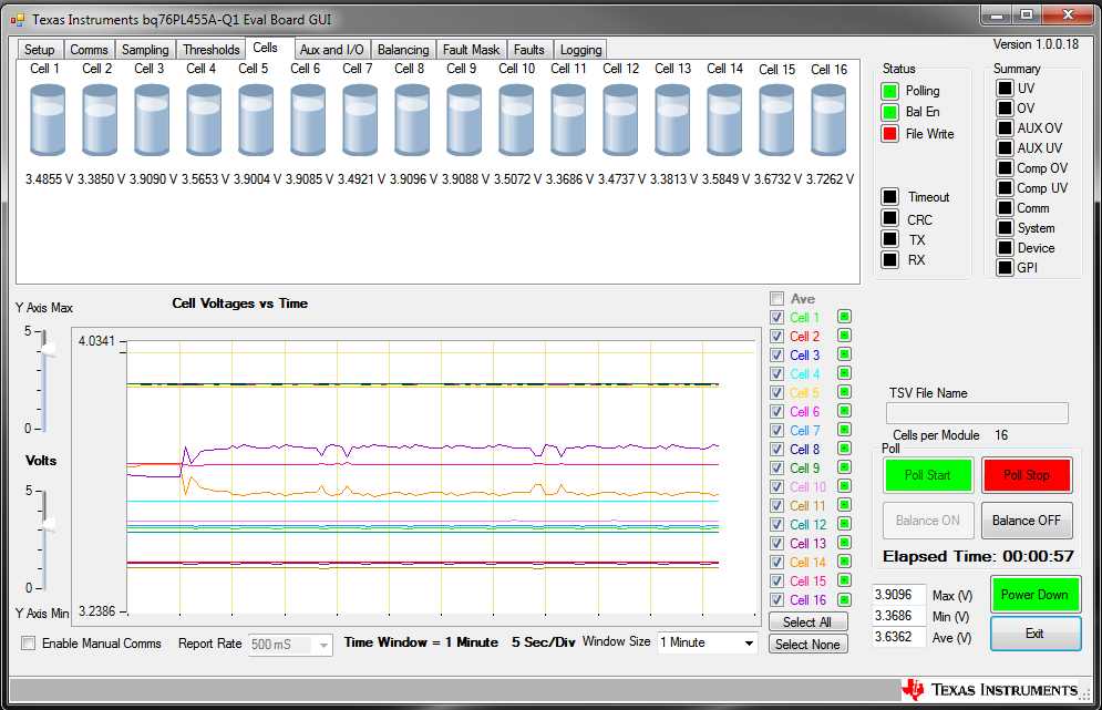

    In the meantime, I replaced one of the cells from my 12V source because I found it to be dead. Now, I am able to reproduce the balancing waveforms I achieved earlier - but they still are not correct.
    Here is a picture of what I am seeing. Can you make any sense of it? It is apparent that there is an attempt to balance being made, but an overall change in voltage is not seen - the cells go back to their original voltage after each "balancing" period.

  • Hi Emory,
    From that plot alone, I will not be able to diagnose what is happening. If the converter is not working properly, you will have to look for abnormal waveforms there.
    The spikes you see in your plot is the I*R drop from the balancing current. From that, we can see what "shape" the balancing current waveform is. If a channel looks abnormal (such as the orange/purple, we can look at those channels and start working from the cells to the converter to see what is happening.
    A question I should have asked a while ago- what cells are you using, and how many in parallel? I noticed that the GUI window has a 1 minute logging period - so you are only balancing for a few seconds. Even at 5A of balancing current, there will not be much capacity gained in the cell during that time period. This is probably why the voltage is not increasing.

  • Hi Emory,
    Are these in parallel (so 16s16p)?
    You could if you wanted. This configuration is fine - just know that the more capacity you have, the longer it takes to balance.
    For example, say you had 10 1000mAh cells all in parallel. For easy math, we can say it is a single 10000mAh cell. If you are balancing with 5A, it will take you 10Ah/5A = 2 hours to go from completely empty, to fully charged. A simple C-Rate calculation is usually a reasonable estimation of how long it will take to balance. In practice, this means that you really have one variable you can change - the balancing current. On the EM1402 this is done by changing the VSET DAC output.
