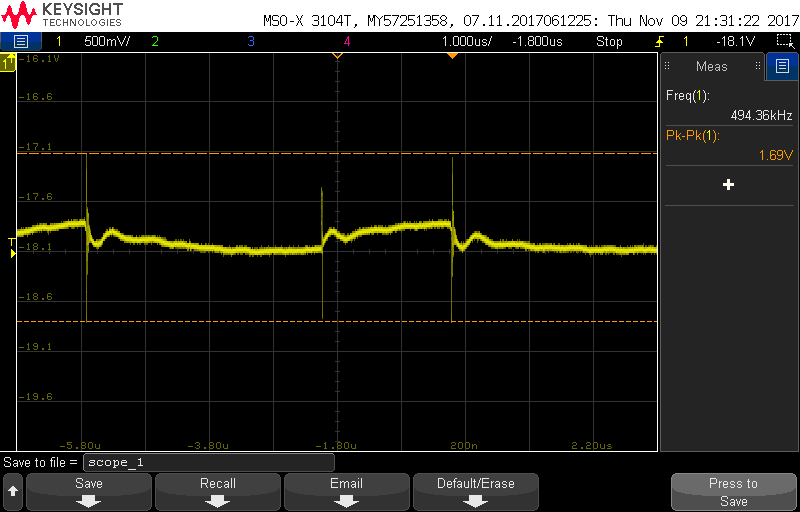

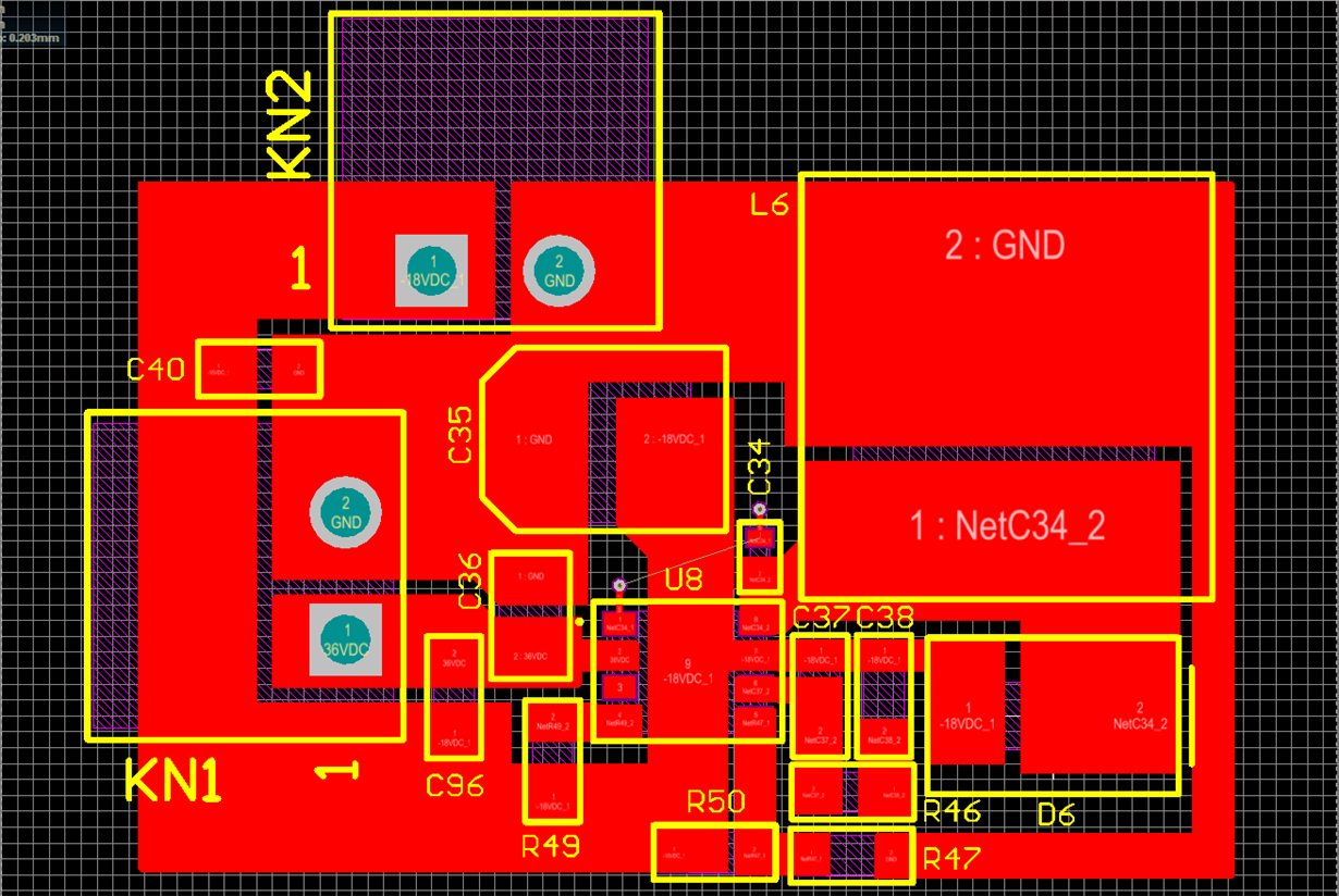

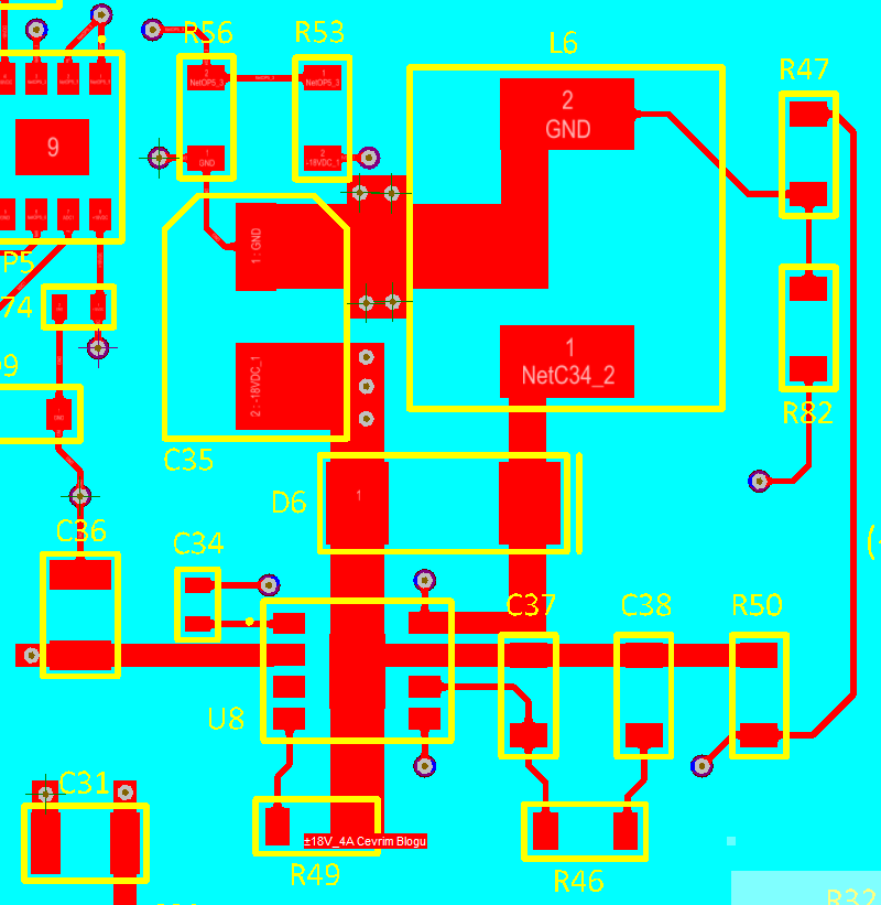

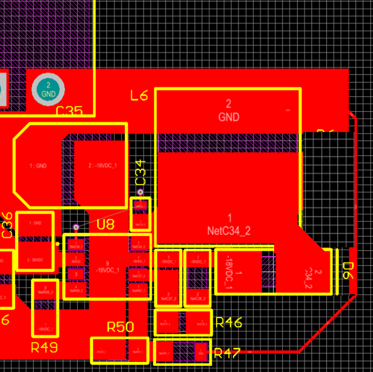

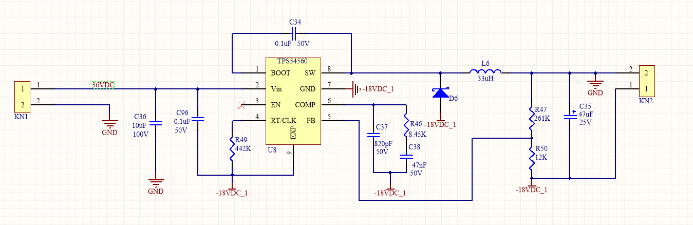

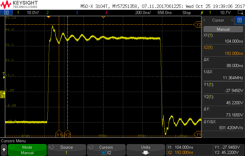

I have -18V@3A power supply design according to excel sheet given its website.

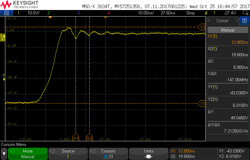

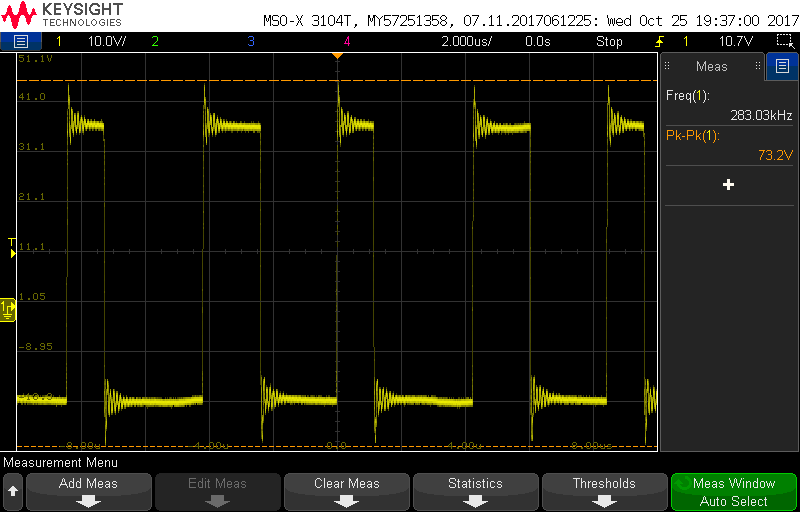

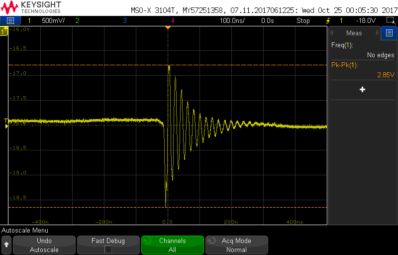

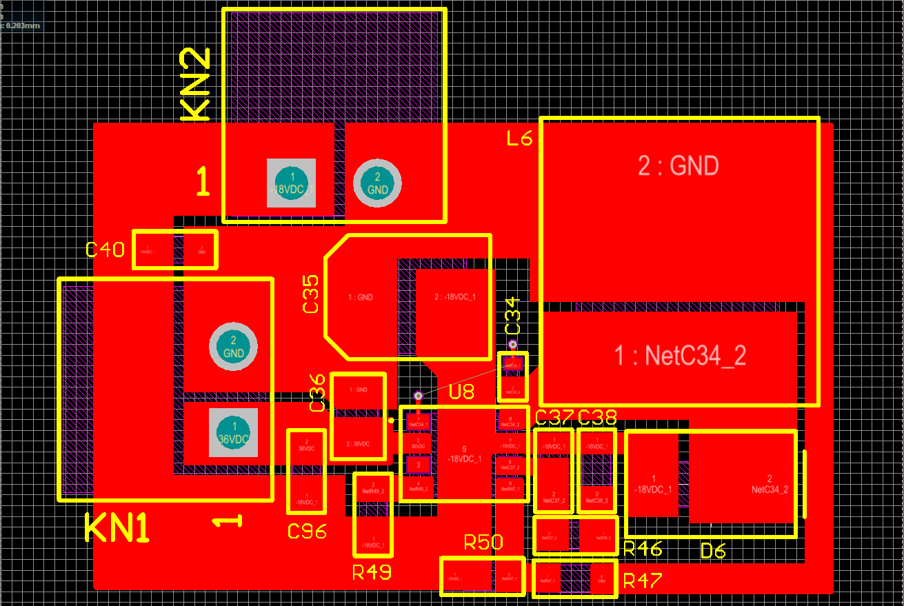

I have used all components according to calculations in excel sheet. But there is a high frequency ripple problem at full load as shown below.

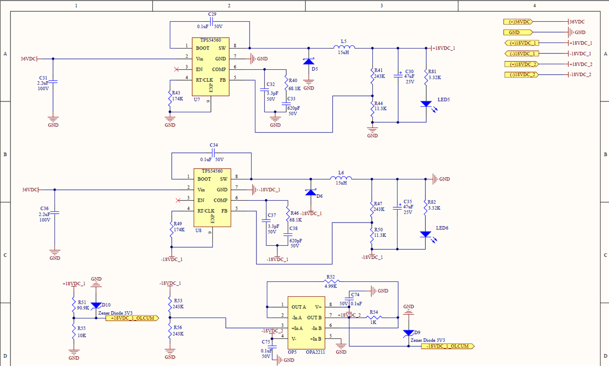

I have also +18V supply with the same switcher again using components calculated in excel sheet. But its high frequency ripple is around 600mvpp at full load.
Measurements are taking with 1 GHz oscilloscope and barrel&tips method from directly output capacitor.
I could not find ant method to reduce this ripple, do you have any suggestion?
