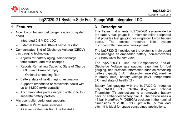

             Could I know what is the difference specification between bq27320-G1 and  bq27320 ? Thank you.
BR
Patrick
  • Hi Patrick,
    The bq27320-G1 was the earlier version that was released. The bq27320 is the final version and what is currently shipping. It has some algorithm improvements and that is what you should be using. You can simply upgrade the bq27320-G1 device if you have that with the bq27320 firmware.
    let me know if you have further questions.
    thanks
