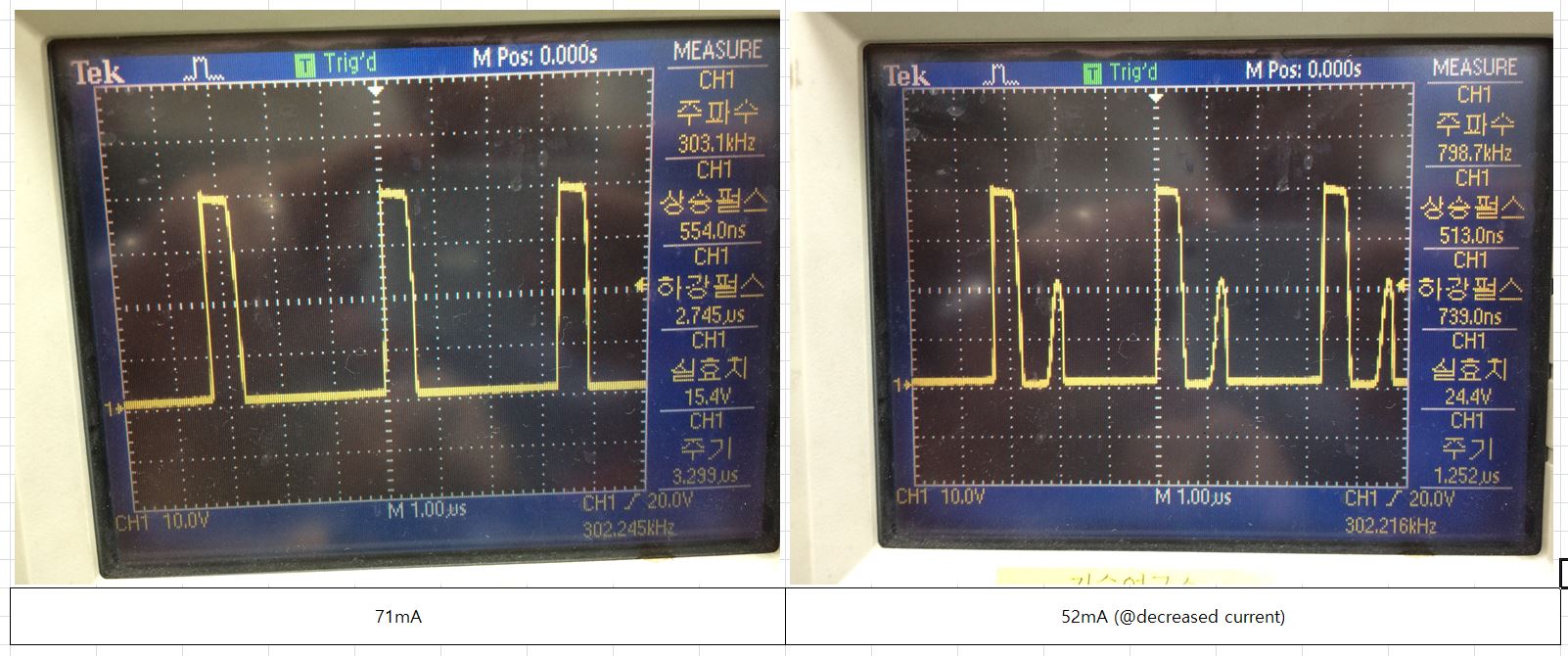

I have been using TPS92511 .
It is supposed to drive the load of 71mA constant current. (@Vin:40V, VLED:36V, RIADJ:21kohm)
However, after several seconds, the output current decreases on several board. (71mA-->52mA)
I measured LX pin and find out switching waveform is changed.
switching frequency: 300kHz
Could you let me know why? How can I improve this issue?
