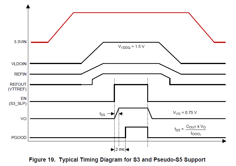

in TPS51200 datasheet, 3.3Vin is earlier than VLDOIN 1.5V rail?
but in customer's system, 1.5V is also to power Vcore, so 1.5V VLDOIN rail is earlier than 3.3Vin.
is there any risk for TPS51200 application?
