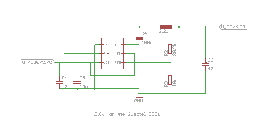

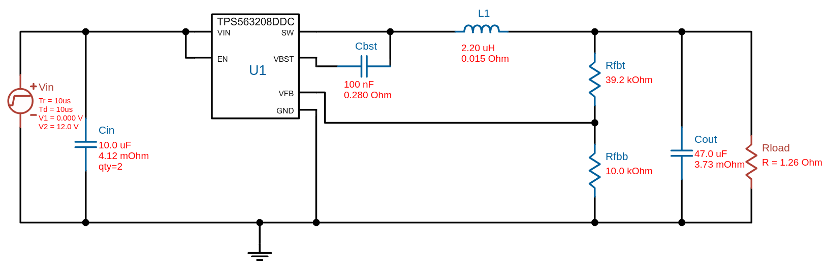

we are using the TPS563208 to step down 12V to 3.8 V to power a Quectel EC21 Modem. Please find attached the schematics as generated by the TI design tool.
Cout 47u C-EUC1206 C1206 CAPACITOR,6.3 V, ± 10%, X6S
2 x Cin 10u C-EUC1206 C1206 CAPACITOR, 25 V, ± 10%, X7R
With our first prototype using the same schematic no audible noise was observed. However with the second prototype with a different Layer thickness, we are observing audible noise from the device especially when the modem is sending GSM data. The modem datasheet specifies a voltage drop of upto 400mV during such transmission bursts.
1. Is the noise from the MLCCs 'singing'? I've read this note form TI but I'm not sure any of the recommended solutions could work for us. Would moving the capacitors to the edge help?
2. How can I be sure that this singing is not from the inductor?
3. Do you forsee any long term functional problems if this singing is not eliminated?

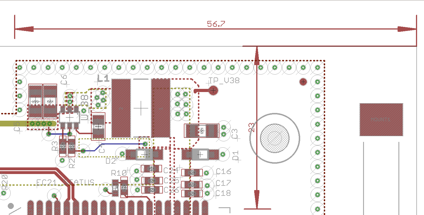

  • Hi
    Did the two prototypes have same circuit design and use same external components? if yes, then problem should be caused by layout. improper layout will cause unstable switching and inductor may produce audible noise. pls upload the layout for checking.

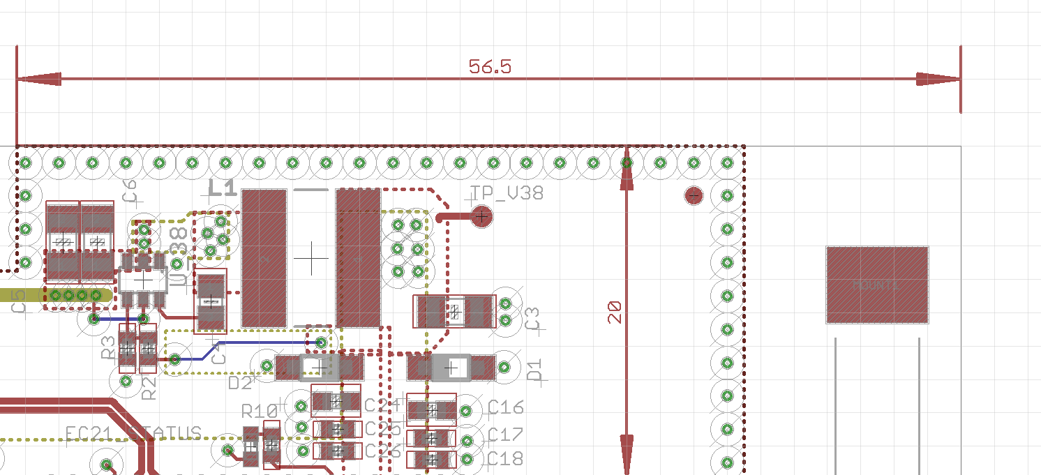

  • Hello Andy,
    Thanks a ton for your prompt reply. Sorry it took me a while to get back to you.
    Here are the actual schematics and layout.
    The new prototype uses the same schematic, the only difference being the size of the board has increased by around 3mm on one side and there is a new hole in the vicinity.
    The new prototype also uses a different layer build up. The thickness of the different layers in the PCB were adjusted to ensure impedance control where required.
    The third layer in the PCB is the VCC layer which is also used for the switching signal.
    The external components remain the same, but I cannot be sure that they're from the same brand.
    I'm not if this info is sufficient for your analysis, if you need anything else, please do let me know.
    New Layout
    Old Layout
    Commn Schematics for both  prototypes
  • Hi Pradeep,
    For your three questions:
    A: If the noise is from the MLCC piezoelectric noise, then moving the caps to the edge will help. I would recommend you to change the cap value or switch to NPO(COG) caps to try first to see whether they are the noise source. If so, change cap value or change layout is necessary.

    However since the same components work flawlessly on the previous prototype, I'm guessing the noise source has to be mechanical. The capacitors are now farther from the edge, maybe that's the issue. Also the hole in the board, maybe that disturbs the structural integrity somehow?

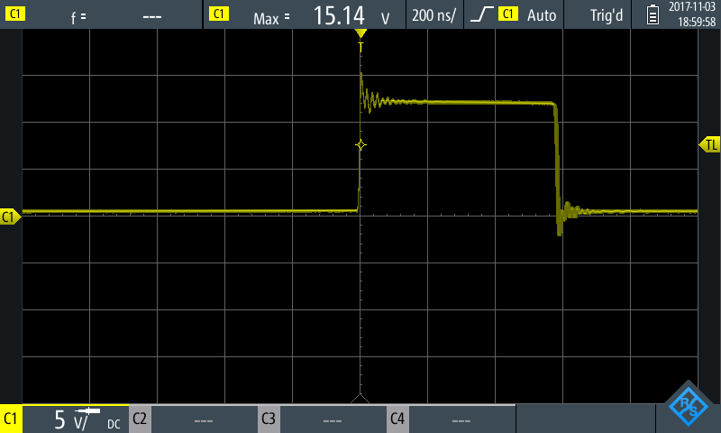

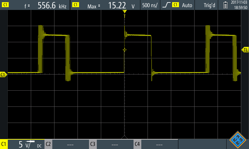

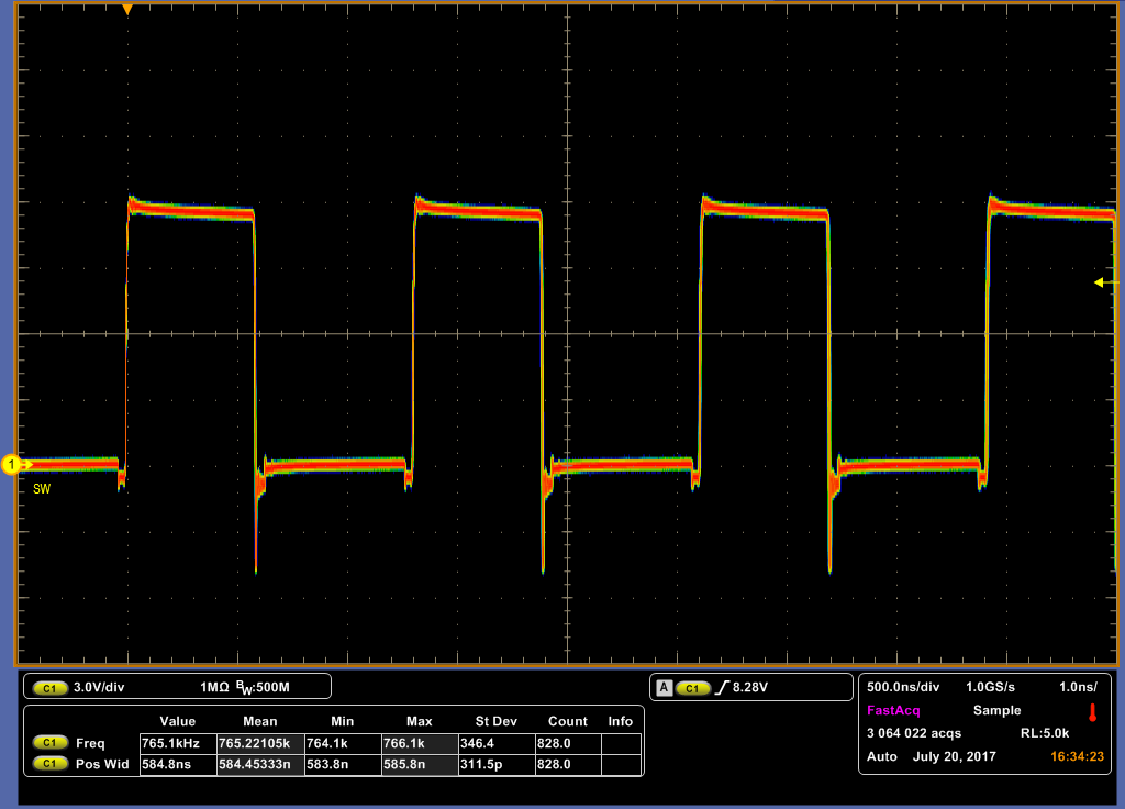

  • Hello Anthony,
    The switching frequency oscillates between 560-580kHz . Please find below the screenshots from the oscilloscope recording the switching frequency waveform.
    Is this stable enough? Or do you think the auidble noise could be from the inductor?
  • Hi Pradeep,
    The oscillation or jitter should be normal here. The frequency is around typical. I don't think inductor is the noise source.

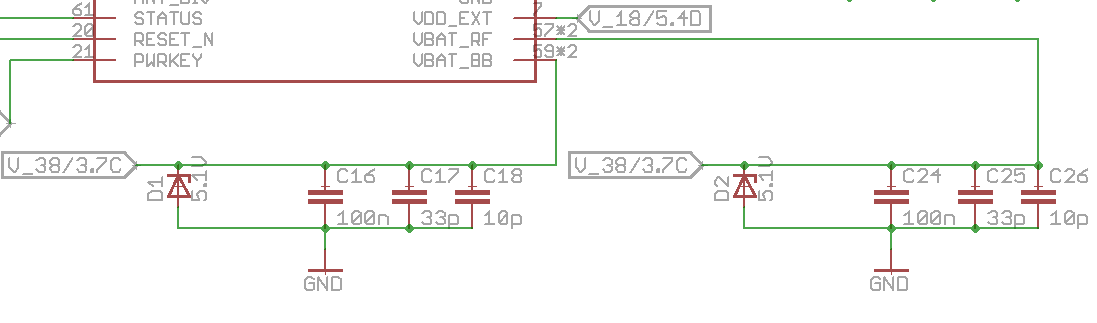

    I tried something unconventional. I desoldered the VOUT capacitor from the board and connected it off the board with wires. This is of course not the optimal layout, but I wanted to decouple the capacitor from the board mechanically. It doesn't make that much of a difference. Either the noise source is some of the smaller capacitors we have further from VOUT to the EC21.
    Or the the inductor might be the noise source. Is it sufficient if I check the switching voltage waveform under rapidly changing load?
    If the inductor is the noise source, then would changing the inductor to another component work? Or do the capacitor values have to be changed?
    Thanks for your support.
  • Hi Pradeep,
    Sorry for the late. Have you tried to turn on the persist function on the scope to capture the SW waveform? It will show the SW jitter in a long time scale.
