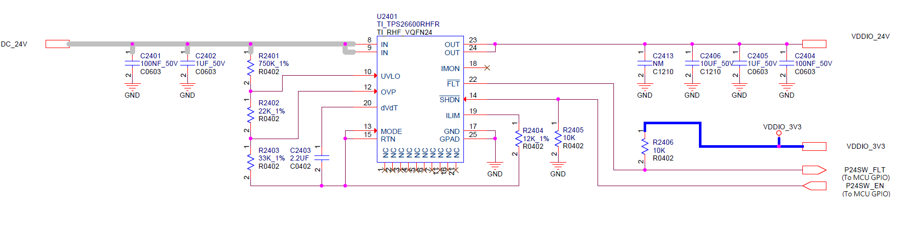

TPS2660: Behavior of FLT/ pin with no load at Vout
Part Number: TPS2660
In my design, when TPS266000 output 24V without load, the FLT/ pin switches back and forth between high and low.
Is the behavior of FLT/ normal?
I cannot find any information in the datasheet.
Anyone can help to explain the behavior of FLT/ when there is no load?
Below please refer to my schematic.
