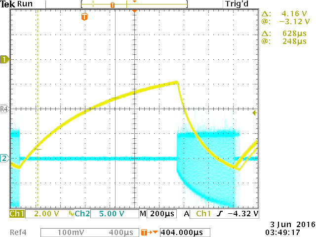

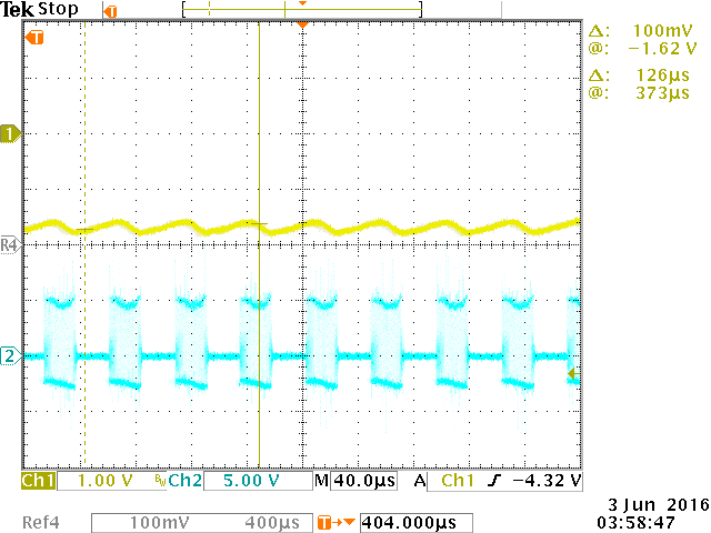

  • Brigitte-san,
    I attached the wavefrom as below,
    1. L=4.7uH, Cout=10uF x4, R3=100kohm, R4=60kohm, Cf=nothing
       Yellow: Vout, Blue : SW node
    2. L=4.7uH, Cout=10uF x4, R3=100kohm, R4=60kohm, Cf=10pF
    Could you please check those waveforms? Also, please give me your advice for improvement.
    Yusuke Mukuno
  • Yusuke-san,
    Thanks for the measurements. Could you provide us the schematic as well as the layout of your application?
    Please be aware that the regulation loop of this part is susceptible to noise. It must to be made sure the feedback/feedforward network as well as the compensation network needs to be routed noisefree on the signal site as well as on the ground site.
    If you place a 50-kOhm damp resistor in series to the feedforward capacitor , will this improve the behavior?
    Best Regards.
    Ilona

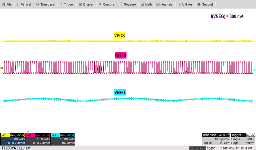

  • Hello Yusuke-san,
    I've tried to replicate your observation but so far was unsuccessful, see scope plot (PSN=OFF). Output voltage ripple of VNEG is not acceptable, no affection of VPOS. Similar behavior I see with PSN=ON accept that it skips pulses at a lower frequency ~200 Hz.
    This is measured with settings as you proposed (VI=5V, Load = 300 mA and PSN=OFF). Tomorrow I will check further more on the feedforward network.
    Can you describe the modification you did exactly when the ripple started to increase? Did you use other caps and inductors (but kept the values the same)?
    Thank you.
    Best Regards.
    Ilona

    Is  the oscillation of your waveform at pulse skip mode? (PSN = ON/OFF)
    If yes, Could you explain about the conditions of becoming pulse skip mode?
    At PSN=OFF, I seem, this wavefome frequency is about 33kHz (30us).  How do you think about cause of this Vneg wavefome?
    At PSN=ON (lower frequency ~200 Hz), If you can post the waveform on E2E, can I see the waveform? Do it have too big ripple?
    Yusuke Mukuno
  • Hello Yusuke Mukuno,
    I expect that the 60k resistor connected to VREF draws too much current out of VREF, causing the reference to get instable. If the reference is instable, both output voltages will reflect this.
    In the electrical characteristics the current that is tested to be available on VREF is 10uA. With 60k you draw more than 20uA out of the reference.
    Brigitte
