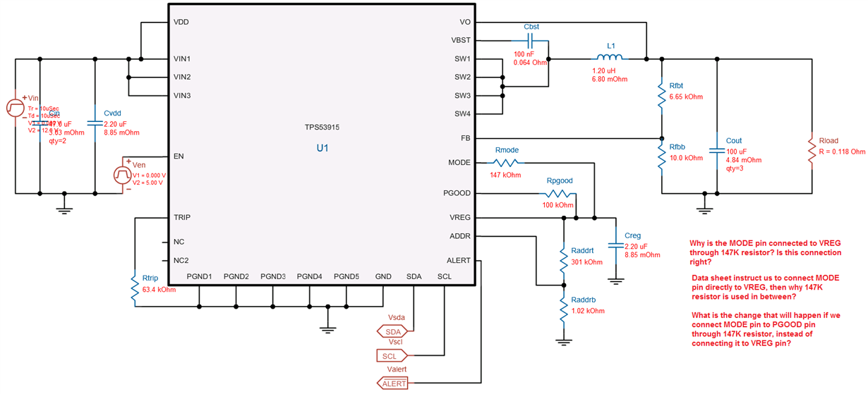

Please find the attached schematic that generated using WEBENCH. The circuit is designed for 400KHz switching frequency with 12V input and the expected output is 1Volt at 8.5Amps.
Q1. Why is the MODE pin connected to VREG through 147K resistor? Is this connection right? Datasheet instruct us to connect MODE pin directly to VREG, then why 147K resistor is used in between?
Q2. What is the change that will happen if we connect MODE pin to PGOOD pin through 147K resistor, instead of connecting it to VREG pin?
Q3. Is it advisable to float all PMBUS signals such as SDA, SCL, ALERT, ADDR , if PMBUS functionality is not used ?
