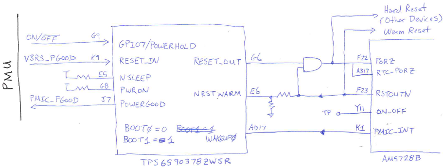

we are working on a design with the TPS659037x PMIC and AM5728 and the question is about whether we can use POWERHOLD to turn on/off the system.
The AM5728 has an errata i862 where it needs a PORZ to have a reliable reset. The workaround describes the use of POWERHOLD.
Implementation 1: PMIC asserts porz when rstoutn is connected to PMIC
NRESWARM input

Does POWERHOLD cause a reliable RESET_OUT signal and reliable Power Up and Down Sequences?
Is the below block diagram a sound solution for using POWERHOLD as on/off mechanism?

  • Hi Gunter,
    Yes, POWERHOLD will always do a cold reset, which means the PMIC will sequence off all its outputs, then sequence them back on. RESET_OUT is part of this sequence, and therefore will be asserted low when the PMIC is shut down. So toggling POWERHOLD will always toggle RESET_OUT.
    You don't necessarily need a gate from NRESWARM to PORz, the PMIC's sequence will handle this internally. You can reference figure 10 of the TPS659037 user's guide for AM572x, which shows that when BOOT1=1, then a warm reset will toggle RESET_OUT. In this case, the PMIC handles the workaround internally, so you don't need an AND gate from NRESWARM to PORz.
