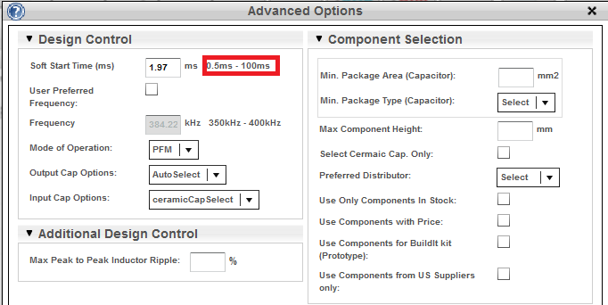

Our customer would like to know the Min and Max values of Soft start(tss).
However, I can’t find those values in the datasheet while according to WEBENCH, those values are 0.5ms(min) and 100ms(max).
Are these values correct?
[Conditions]
VIN=4.0V to 8.4V
VOUT=10.5V
IOUT=around 3.5A
Kanemaru
  • The Webench gives out a draft value of softstart time. You can change it by chaing the ss cap value . or you can choose a time, then webench will give out the ss cap value. Since in the real applciation, the ceramic cap itself has tolerance/ the IC itself has toleracne , so the real ss time will be 'around' the time you set in the webench.

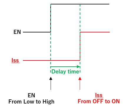

    They would like to know the delay time from "EN is changed from Low to High" to “the soft-start charging current(Iss) begins to flow".
    Could you please let us know if you have any information?
    Kanemaru

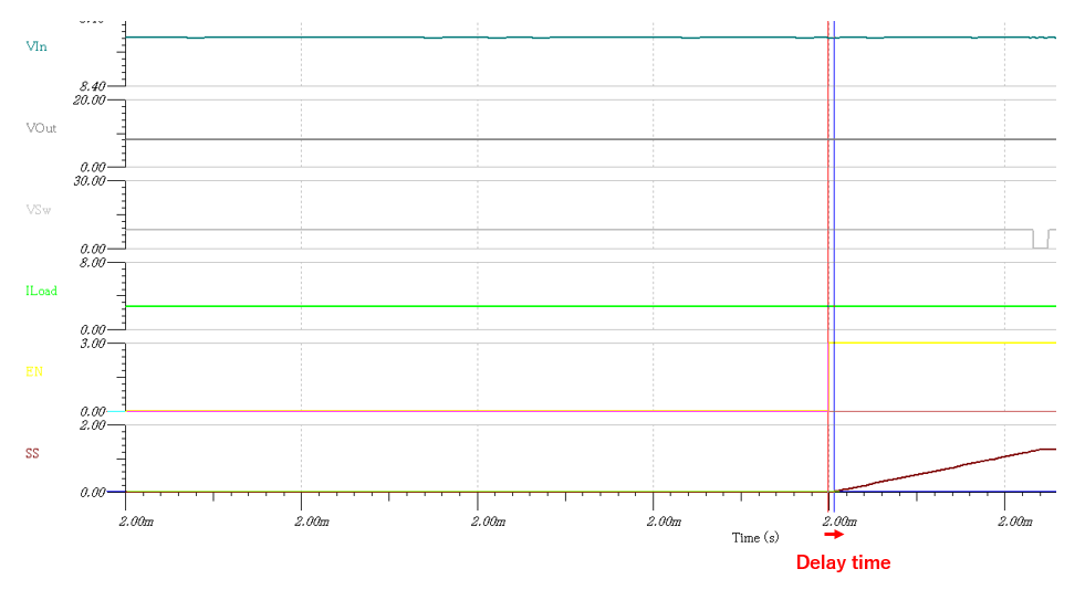

    2. The duration from EN high to Vo begin to rise(Iss from off to on) is around 4ms.
    (Answer)
    I apologize for any confusion.
    The soft start time which they set is very short.
    Therefore, they would like to confirm this delay time.
    (If this delay time is more than 1.1us, I guess that they can’t set tss=1.1us).

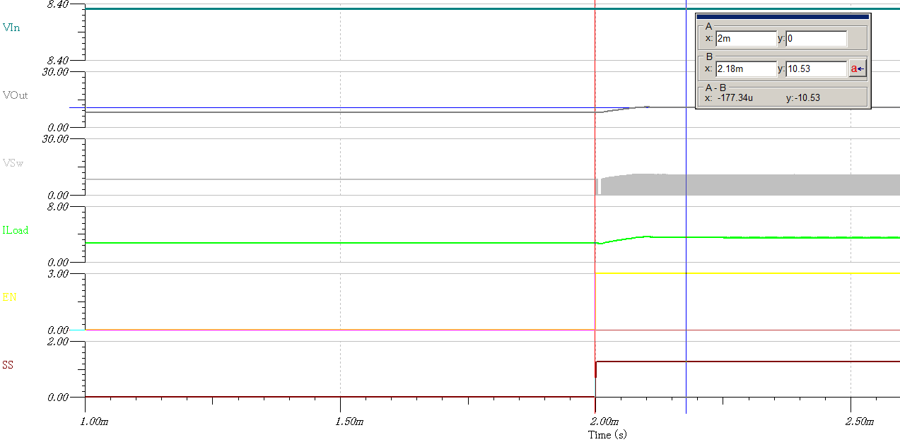

    By the way, I simulate TPS61088 by TINA-TI.
    As a result, the soft start time was around 180us so the soft start time don’t meet 1.1us.
    Is this correct operation?
    Kanemaru
  • From the datasheet, you can see tss means: The soft-start phase is completed after the SS pin voltage exceeds the internal reference (1.204 V). So if the Css is very small, SS pin voltage ramp up very quickly to 1.204V. then Conveter works in the "full duty cycle" untill the Vo reaches the target Vo. So Tss not equal  to Vo rise time.  small Css can make the Vo rise quicker, but the Vo rise time is also depend on the load current, output capacitance.
    So the simulation from the TI-TiNA is correct!

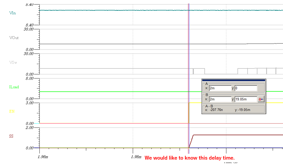

    I have one more question.
    I understand that the following delay time is “less than 200ns”.
    Is this information correct?
    Kanemaru
  • Yes, correct, the time is very short, around 200ns.
