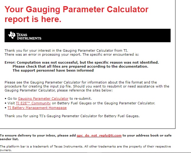

Dear sir,
For chem id calculation i tool discharge reading for different temperature on different current rate for my battery.After the process completed i updated my zip file the error will come represent in my attached image.can you please resolve my error.
  • Hi Arun,
    Can you repond to the following:
    -send File you submitted to the tool
    -Number of cells in series.
    -charge voltage.
    -Battery data sheet.
    thanks
    Onyx

    Thank you sir.
    I found my error and i resolved it.i got one text file from your team.In that i cannot understand anything.what is my chem id like that.Can you elaborate that file.i here with attached that file.please find the attachment.

    Dear sir,
    i uploaded my file and got the result by text file.how can i found "chem id" based on that parameter.could you please help me to find my chem id like "0803".i here with attach my result file for your clarification.
  • Hi Arun,
    Thank you for uploading the results from the test. It appears the wrong tests are being run for this gauge. Fortunately, the fix is much easier than the steps you have been undergoing.
    The bq34z100-G1 utilizes impedance track (IT) technology and requires one configuration file and only one log file to generate the ChemID. The text file and tests in your file above are for a CEDV Gauge that requires a configuration file and 6 log files to generate the ChemID.
    If you are using the bq34z100-G1, or another IT gauge, please follow the steps found in this document: www.ti.com/.../slva725.pdf
