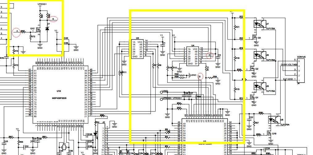

Hi everyone,
i am using three bq76pl536s in a bms project ,  my question is about the CS_H  design of the bq on the bottom chain, i wonder if there problem on my SCH ;
i do as the follow :
http://www.ti.com/lit/ug/tidub04/tidub04.pdf  page 15.
but ,the question is,when i set the resister between CS_H and LDOD  is 1k; i found that the LDOD canot go up normally such that it keeps 0V ;
when  i set the resister to 5.1k; and it works normally;
so i wonder which value of the resister is suitable or the sch itsself is wrong;
the othe question is ,in some product of this project ,some bq consumes high current after it goes to sleep a period of time ;it seems like the bq active itself after it went to sleep fo a period of time;

    1K pull up to LDOD is okay. 5.1K is still okay.
    We have 1K pull up to our evm and found no issues.
    ARe you loading extra to any of LDOs? There is max loading to the device.
    No issues reported with 1K.
    Do you think you can share the schematic with me?

    and  my SCH is below:
    when the bq in sleep state ,The power of the mircro cpu cut off ,and just bqs remain its power from the battery ;
    besides, the voltage of REG50 goes down slowly ; and the CS_H of the bottom bq,goes up to almost 4.75V ~4.9V;
    the current flow into the vcc of the bq in the bottom chain is about 12~15uA ;
    So this work state of the bq looks like very good; but the fact is , this three bqs  consume much more current (guess :above 2mA )after several days () later differently;
    Now i donot know when and How the bq begin to work abnormally;  The moment i found the this issue,the voltage of the total bq went to almost zero cost by the bq itself ;
  • your schematic looks okay. I would use 10K pull-up to LDOD. 10K is still consider strong.
    It's not a problem but this is something you need todo everytime you connect cells to PL536A.
    You have to clear ALERT and FALUT registers.
    You will have ALERT and FAULT conditions when you 1st time connect your cells.
    You are seeing high current because you have FAULT register bits.

  • You have Zener on CS_H Nmos circuit. Please check the leakage of Zener. Check the Datasheet.
    I recommend customers to float DRDY_H pin. you have to do something similar to this pin like CS_H. BUt floating is one quick option. I would float it.
    REG50 MUST be 0V in sleepmode.
    IF you read 5.0V then device is not in sleepmode.
    1. Check spec of your zeners. Makes sure they are low leakage zeners.
    2. double check that REG50 is 0V. Are you sure that reg50 was 0V and ALERT_H and FAULT_H are also 0V.
    26uA sounds like leakage from zener.
    I would also change R91 and R92 to 20K so equivalent pull up is 10K.
