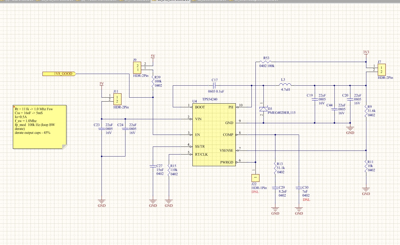

I am designing a buck regulator shown below.
The jumpers J11 and J9 are installed.  C30 is not installed, I just put the footprint on the board.  J7 is not installed so the load doesn't affect the supply yet.  I simulated this in tina with a step load etc...and it looked fine.  Unfortunately it is not working on my board.  R13 and C29 are installed.
Could someone elaborate on how I've gone wrong with the compensation network?

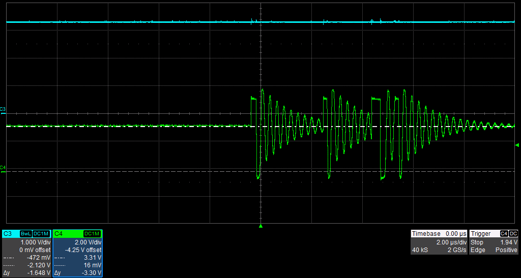

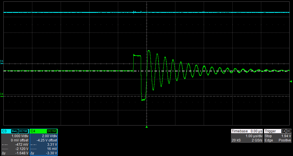

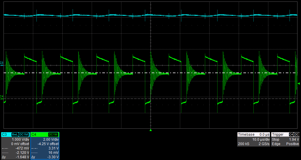

    I was mistaken.  This circuit is not regulating correctly under load in this configuration either.  I initially though removing the compensation components allowed  the device to regulate  at  the expected 3.3V and it does but only without  a load attached.
    These screenshots were taken with the design described above with NO compensation components loaded.  The  top (blue) trace is the output and the bottom (green trace) is the PH pin (pin 10) of the TPS54240.
    Below is the key describing  the configuration of the circuit each screenshot was taken in.
    LeCroy13.png - Screen shot of the circuit  with no load  and no components connected to the COMP pin.
    LeCroy14.png - Just a  second screen shot with the same  configuration as LeCroy13.
    LeCroy15.png - Same probe points, but the output of this regulator now has a 7.5 ohm load.  Nothing is connected to the COMP pin.

    From you sw waveform at load it looks like there is a lot of droop in the waveform.
    This may be from the resistance of the very narow traces that I mentioned above.
    Not sure about the comp components making a difference, however you will need a better layout

    The comp components and FB resistor must be ground at the gnd pin of the device, like the example on the data sheet layout.
    Then that gnd is connected to the DAP.
