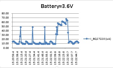

  • note:
    Here is our measurement result that shows Fuel Gauge BQ27220 sleep current in 60 seconds:
    already enter sleep mode and have lowest power consumption??
    Battery=3.6V
    Average (60sec)= 12.54
      Time I_BQ27220 (uA)

  • Hi Hb
    Do not set the dsg relax time to 0, keep the default. Setting to 0 will not reduce the sleep current. Disabling the wake comparator might reduce the current draw by a little bit.
    What exactly is the problem here? Are you unable to enter sleep mode?
    thanks
    Onyx
  • Hi Onyx,
    Our task is trying to let BQ27220 keep lowest power consumption in sleep mode by using a battery. If we can keep lowest current, our battery can save power more time till user start to use our device.
    1) BQ27220 will enter sleep mode automatically, so we don't need to set additional configurations for BQ27220 to enter sleep mode.
        Based on our current measurement result, I think we have already enter sleep mode, right?
    2) What we measure the current value of BQ27220 is not static 9uA value, it is floating value due to wake-up. Range is around from 9uA to 60uA. Average current value is around 12uA in 60 seconds.
       Can we reduce more sleep current in BQ27220? or avoid large wake-up current.
    3) BQ27220 don't have shutdown mode that I heard from TI FAE, can you confirm this? Because TRM still has shutdown mode flow, but we cannot find register to achieve shutdown mode. We can achieve shutdown mode in BQ27621 that we used before.
    thanks
    HB
  • Hi Hb,
    1. The bq27220 will enter sleep mode as long as the sleep conditions are met. so yes if you see about 12uA current draw, then yes you are in sleep mode.
    2. Yes you will not see static 9uA. The gauge wakes every 1s while in sleep but doesn't take any measurements. It will however take measurements once ever sleep current time and once ever sleep voltage time which i believe is 20s. This time varies based on which gauge. So you seeing 12uA is correct. The gauge has to wake to take measurements to maintain accuracy and when it wakes you will see those current spikes. There is no way to reduce the spikes. You can reduce the overall current consumption in sleep mode by increasing sleep time which is how often the gauge wakes to take measurements. You can double or triple that time from 20s to say 60s. You just have to make sure the guage isn't missing load currents during that increased interval.
    3. The device does have the shut down mode, but the draw back is that you will loose all previously stored data on the gauge if you to shutdown. it will go to its original default setting . You will have to load your gmfs file and the learned FCC to the gauge to resume accurate gauging upon wake up.
    I hope this helps.
