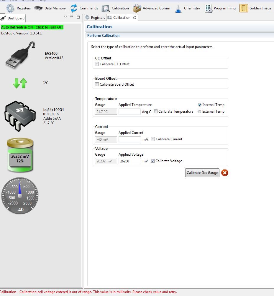

I am using a BQ34z100-g1 with an 8s2p LiFePO4 batteries. I have created a golden image and load it in all the devices.
However I am having problems with the voltage calibration. Most of the time I try to calibrate voltage battery I obtain the following error "Calibration-Calibration cell voltage entered is out of range. The value is in millivolts. Please check value and retry"
I am using EV2400 version 0.18 and bqStudio 1.3.54.1 and I ma not having problems calibrating current or temperature.
1. What can be happening with voltage calibration?
Thank you very much in advance,

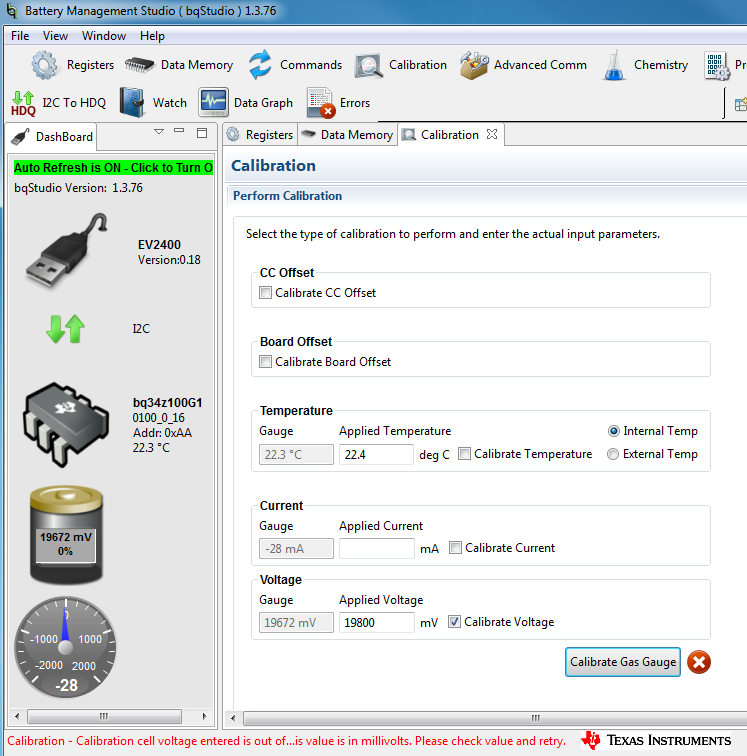

  • Hi Onyx,
    I have downloaded the version 1.3.76 and still have the same problem as you can see in the following images
    1. What can be hapenning?
    Thank you,

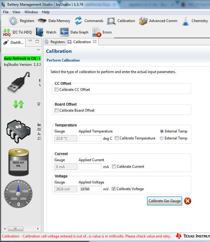

  • Hi Onyx,
    First of all I have loaded the firmware in the BQ34z100-g1 (obtained from here ).
    After that I have laoded the correct chemistry and modified parameters of BQ34z100-g1 such as pack configuration a, b and c (0x29a4, 0xa6, 0x27), cell charge voltages, flash update OK cell voltage (=2250mV),...I cannot export the gg.csv file with this new bqStudio version, this program is very very dissapointing.
    And then I have gone to the calibration screen and first try to calibrate the voltage. However it has been imposible to achieve it. Always the same message, showed in the following image.
    I have tried to enter the total voltage of the battery and the cell voltage but both times the answer has been the same.
    1. What am I doing in a wrong way?
    Thank you,

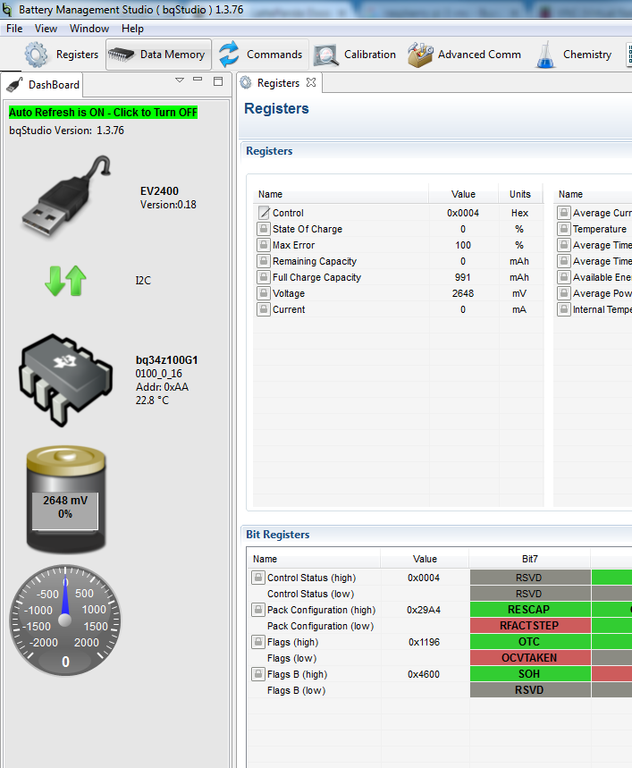

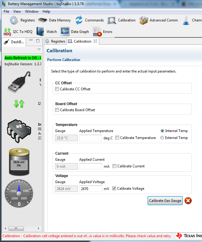

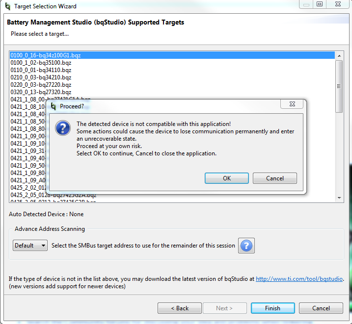

  • Hi Onyx,
    Yes, I have loaded g1 version, but not from bqStudio, I have downloaded it from TI webpage (
    When I start the bqStudio the first time in the day and select the bq34z100-g1, I always obtain the same screen (selected device not compatible with this application). If I close and start it again without having turn off the computer this message does not appear.
    I push OK button to continue and the bqStudio starts with any other problem.
    Now in the dashboard I can check that bq34z100-g1 version is the correct version (0.16) and bqStudio is the 1.3.76. Yo can see both in the following image
    And now I try to calibrate voltage. Fist of all I introduce the battery cell voltage with the following result
    After that I try introducing the battery voltage but the result is the same
    What do you think it is happening, Onyx?
    Thank you,

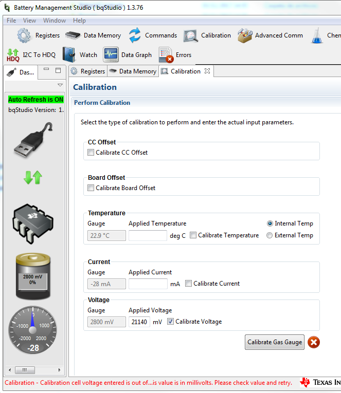

  • Hi Gorka,
    When you upgraded from version 1.3.54.1 to 1.3.76, did you install over the previous installation?
    Please make sure you're using the up to date bqz file for the device as there was an issue with the bqz file distributed with the 1.3.54.1 version that has since been fixed in the 1.3.76 build 3 version.
    Please try either/both:
    A) Reinstallation
    1. Fresh install of bqStudio 1.3.76 build 3
    B) Fixing the File for bqStudio 1.3.54.1
    1. Download this specific 16 version of the bqz file (I realize you have downloaded it from the site previously, but lets try with a fresh version) located here: e2e.ti.com/.../2577.0100_5F00_0_5F00_16_2D00_bq34z100G1.bqz
    2. Rename/remove the prexisting bqz file in C:\ti\BatteryManagementStudio\config
    3. Place the freshly download bqz file in C:\ti\BatteryManagementStudio\config
    Please let me know if this solves your issue.
    If the issue persists, it is often due to the voltage divider not being set properly in the software.
    Sincerely,
    Bryan Kahler
  • Hi Bryan,
    I have formatted my PC only two weeks ago so I am pretty sure that only 1.3.76 build3 version has been installed on it.
    That is why I skipped your first step (A) and went directly to the second step (B). Change the bqz file and ¡surprise! now it works :-)
    I will keep you informed about the performance with others device.
