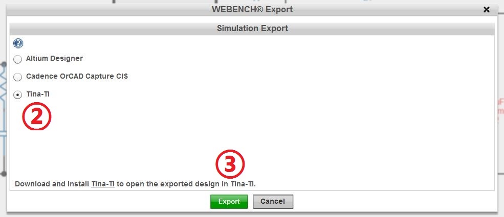

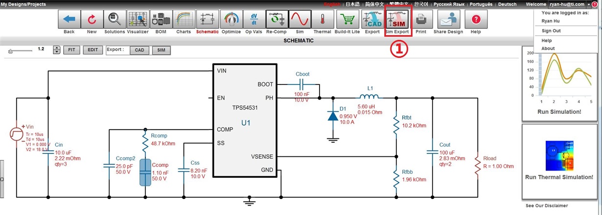

  • Hi Viktorija,
    On Webench design screen, you could use the SIM Export function to create the TINA model for this part...
    BRs,
    Ryan
  • Are you certain this will generate a model for AC Analysis for simulating the gain/phase? I've seen this referred to as the "AVERAGE" model. I believe the only model that's exported from WEBENCH is the "TRANSIENT" model.
