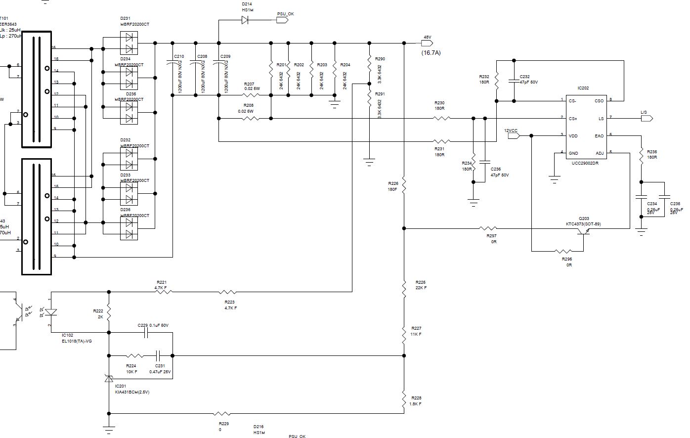

My customer is doing load share with UCC29002.
I want to load share two outputs.
The two current deviations are now higher than I thought.
Could you please review the circuit below?
LOAD : 48V, 16.7A

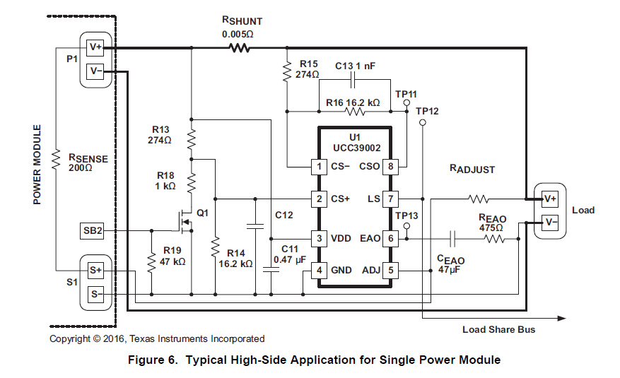

Hi Andy
The CS amplifier gain is chosen by the user and is set by the ratio of the external resistors from CSO to CS- and from CS- to Rshunt. In the schematic below the gain is R16/R15 = 16200/247 or 65. It is a differential amplifier so the ratio of R14/R13 must be the same as that of R16/R15. I copied the diagram below from the datasheet.

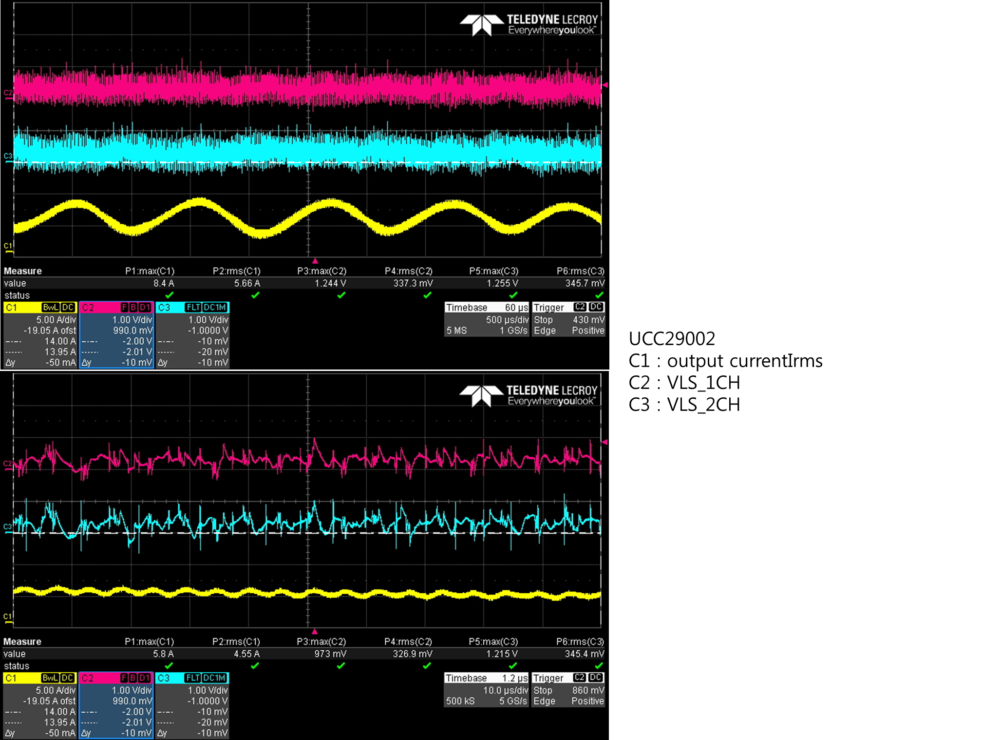

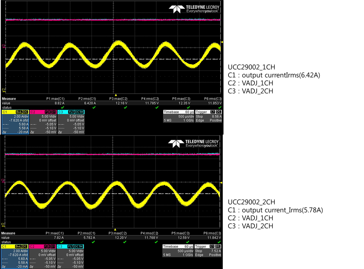

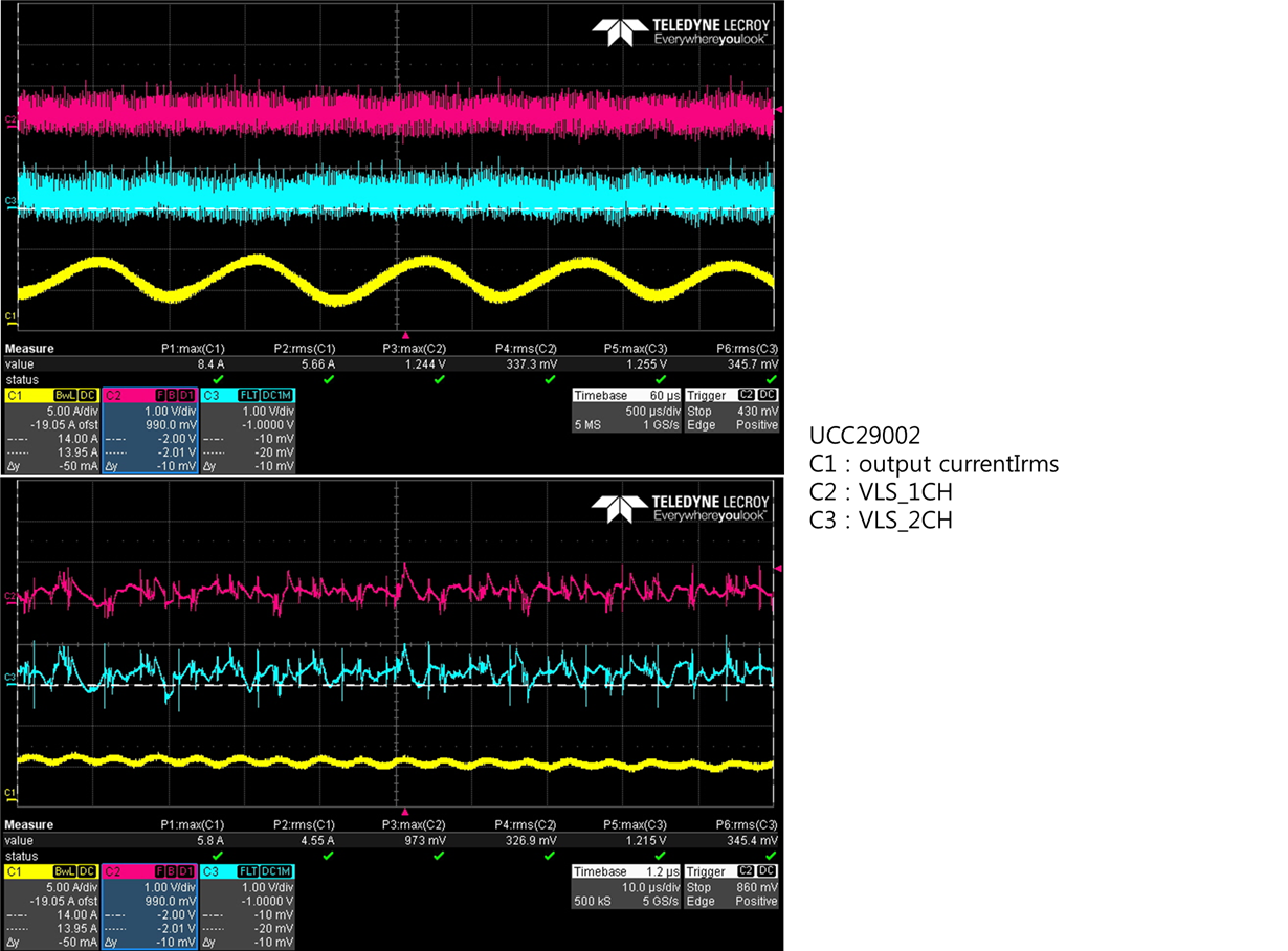

I checked the ls voltage of two circuits and it was as follows.
Two ADJ voltages were also checked.
Iout = 6.42A for Load 1 and Iout = 5.7 for Load 2.

There is an oscillation on the output current at about 33kHz - the customer will need to identify the source of this instability and fix it. I'd first suggest that they remove the load sharing and verify that the modules are stable. They should also review their compensation networks using the information in the MathCad files in the UCC29002 product folder http://www.ti.com/product/UCC29002/toolssoftware There is a .pdf version of the file at /cfs-file/__key/communityserver-discussions-components-files/196/3113.4571.Mathcad-_2D00_-loadshare_5F00_worksheet_5F00_web.pdf
At any given time the LS pins of the two controllers should be at the same voltage.
I haven't done the calculations because it requires a knowledge of the loop response of the modules in the sharing group but the compensation capacitors at the EAO ouput (2 x 0.26uF) are much smaller than is usual.
In principal the load share controller controls the load current and the output voltage isn't a factor. I'd suggest that the user double check their compensation networks and first solve the oscillation issue and then move on to understanding the reasons for the current imbalance.
