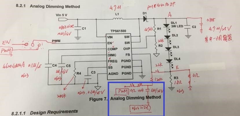

Hi Sir,
      My customer consider using TPS61500 to replace the existing design, but there is an issue, in existing back light driver, the PWM and Enable is separated but TPS61500 is integrated,  the logic AND is suggested to customer to use( both PWN and Enable of outside signal is the input of AND and connected the out to EN of TPS61500). is there any issue if using this design or do you have better suggestion. thanks you very much!
